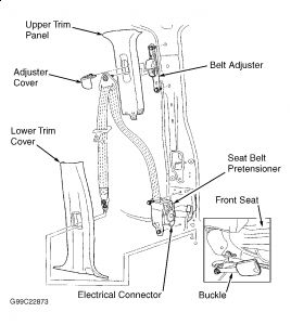

2000 Nissan Xterra 6 cyl Four Wheel Drive Automatic
What steps must I take to install a passenger side seat bely my dog destroyed?
May 2, 2009 at 7:15 AM
DAVE H
  • 13,384 POSTS
SEAT BELT PRETENSIONER Removal & Installation Before proceeding, See AIR BAG SAFETY PRECAUTIONS . Disable Supplemental Restraint System (air bag system). See DISABLING & ACTIVATING AIR BAG SYSTEM . Remove belt buckle. See Fig. 12 . Remove seat belt floor anchor bolts. Remove adjuster cover and upper guide loop anchor bolt. Remove B-pillar upper and lower trim panels. Remove belt adjuster assembly. Disconnect seat belt pretensioner electrical connector. Remove mounting bolts and remove seat belt pretensioner. To install, reverse removal procedure. Tighten all fasteners to specification. See TORQUE SPECIFICATIONS . Activate air bag system. See DISABLING & ACTIVATING AIR BAG SYSTEM . Check AIR BAG and seat belt warning light operation. See SYSTEM OPERATION CHECK . Fig. 12: Removing Seat Belt Pretensioner
