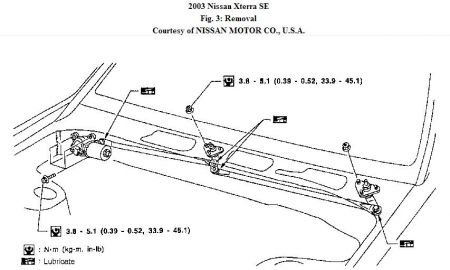

One of my windshield wiper does not work. the driver side wiper works but the passenger side does not work. We had a lot of ice and snow lately.
Does each wiper have a separate motor?
could it be a fuse?
Mar 6, 2009 at 6:23 AM
KHLOW2008
  • 41,814 POSTS
Hi u863999,
Thank you for the donation.
The wipers uses a common motor and your problem should be a dislodged wiper link. You need to check if the link joints are worn.
Are you sure the year model is correct? I could only find Xterra for year 2000 onwards.

I have the diagrams showing the components.
https://images.2carpros.com/forum/automotive_pictures/192750_WiperLinks03Xterra_1.jpg
