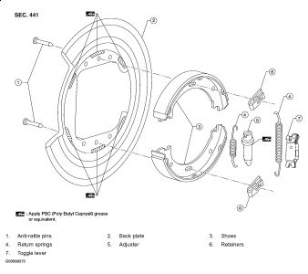

I had a noise a few weeks back and I had it looked at. My emergency brake bracket had got destroyed and I need to replace it. I need to find out where to purchase a new bracket at?
Oct 8, 2009 at 2:44 AM
DOCFIXIT
  • 18,828 POSTS
Hi That would be a dealer item or bone yard.What got trashed? see diagram
https://images.2carpros.com/forum/automotive_pictures/198357_Grafic_3_54.jpg
Let me know Thanks for donate

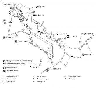

It was the passenger side rear brake bracket and I'm not sure what all got torn up. The mechanic took it apart but was unable to buy one to replace it and I have been without for six months. I'm trying to get it back together before winter. Thanks for the help.
When the mechanic showed it to me it looked like section 443.
Oct 12, 2009 at 12:13 AM
DOCFIXIT
  • 18,828 POSTS
The passenger cable is part number 36530-7S200 $ 77.22 if not cable is it something in assembly?
