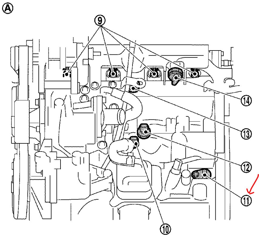

My car is a 2008 model, but the engine was replaced with a 2010 model years ago. Here's a recent maintenance history:
- 2 days ago: Replaced spark plugs, air filter, and PCV valve.
- 1 week ago: Cleaned the throttle body, replaced oxygen sensors, and cleaned fuel injectors.
- 1 month ago: Replaced the evaporator and AC pipe due to a refrigerant leak.
- Last year: Replaced the fuel pump.
This morning, the car began stalling while idling without AC on during a cold start (3 times). Additionally, it stalled once after driving for 10 minutes and parking with the AC on. The car typically stalls at stoplights, in slow traffic.
I've taken my car to five different mechanics, who have tried their best to diagnose the issue. They've used diagnostic tools, but no error codes have been found. Unfortunately, no one has been able to resolve the problem. Car stalls despite all the above efforts.
Do you think replacing the junction box might fix the issue ?
Oct 11, 2024 at 2:39 PM
  • 55,721 POSTS
This problem does sounds electrical. I would replace the crankshaft position sensor first, then the MAF sensor and then the main engine relay. All of these can fail causing the engine it stall without leaving a code. Here is the location of the crankshaft sensor. Check out the images (below). Please let us know what happens.
Oct 14, 2024 at 2:45 AM
SHIRAZ AKMAL
  • 12 POSTS
Hi sir, it was crankshaft position sensor. thanks!! Your advice helped a lot.
