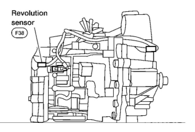

so...this is the problem...I got a nissan sunny n16 and am facing a problem when it starts. The car won't move forward when i move the gear shift from P to D. But it moves when it is moved from P to 1st gear. So gradually when i then move to 2nd and then to D the car picks up. I changed the engine oil but no response from the car at all...same problem. my friends say that it may be an electrical problem but i want to know all the other measurements for this problem....pliz help me.....

Dear I have Nissan Sunny 2011 car with auto transmission. Now the problem is that when I am shifting the gear from P to D then some time the car move forward but mostly not moving forward. Then I am repeating the same 3 to 4 times then the car is moving forward.Shifting the gear from P to R is normal. Also from shifting gear from P to 1 or 2 car is smoothly running forward. I changed the engine oil and gear oil but no improvement and both oil levels are normal. please share how to fix the problem.

These cars had a problem with the input shaft speed sensor for the transmission. It should throw a code but not always. Here is a video of the job being done on a Honda but they are similar.
https://youtu.be/f3bETtCIdxM
Here is where it is on your car. (below)
You might have code for it here is a guide so you can see
