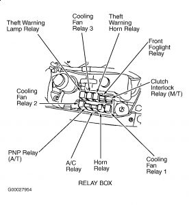

Check for power and ground at the coolant fan motor check for power at the relay

These relays are located with in the fuses box or in a separate box (may be a relay box)

FAIZAN
BMRFIXIT,
I checked the relay box and found that after removing the radiator fan relay and shorting the first set of contacts found that engine fan works fine and if shorting the second set of contacts found that only A/C fan works fine but not the A/C.
Mar 22, 2009 at 10:57 AM
BMRFIXIT
  • 19,053 POSTS
A/C check its fuses again
check if full of gas (134)
fan not coming ON the test you did conform that the motor and wiring from relay to motor good
check coolant sensor and fan switch
