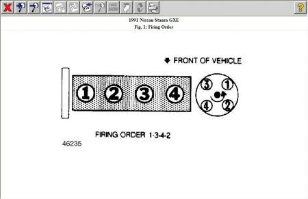

I have a91 stanza that runs great, the only problem I ever had was a missing problem which I was able to fix by changing wires,Then once in awhile my wife would tell me it feels likes its missing and I would play with the wires and find a wire loose,not making contact,so I tried this with and this time it didnt get better,so I changed the plugs,distributor cap,and wires are new,the guy at pepboys told me the plugs are gapped so I would not have to gap them,I then fired up the car and I have the exact miss firing problem,any hints for me,can you tell me the firing order for plugs and cap. Thank YOU

https://images.2carpros.com/forum/automotive_pictures/12900_fo_69.jpg
