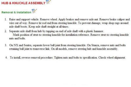

How do I remove the spring clip that holds the axel to hub so I can remove the hub from the axel? Where is the spring clip located?
