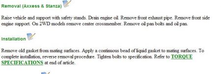

My oil pan gasket is leaking and I was told that I would have to remove the transmission to replace the gasket. Is that true because I don't want to pay any mechanic to replace the gasket or have my transmission removed.

Hi there, this is not the case, see text for information. Mark (mhpautos)
