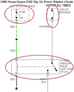

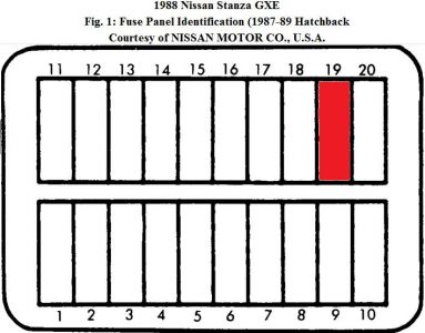

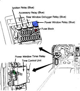

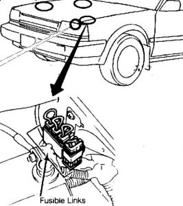

I can't find the fuse. All four windows don't work.
Can you help me. Thank you and GOD bless
Peter
Mar 29, 2009 at 6:47 AM
ZACKMAN
Experienced Mechanic
4,202 POSTS
Check the fusible link (circuit breaker), fuse (#19 10amp), and the relay.
