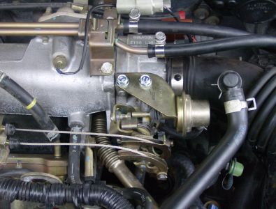

2000 Nissan Sentra, Mileage:168,876 Engine Size:1.8L 4 Cylinder, Automatic Transmission. I had just changed my transmission fluid,filter,and gasket. I started to drive it and it was normal until i got to a stop light then the engine shut off so I restarted it and put it back into gear and it shut off again, so i did the same thing again but I didn't wait before I stepped on the gas and it worked until I got to another light then it stopped again and this time it would turn on but would turn off as soon as i changed gears. I was told that the transmission was burned out so I got a second opinion and was told that my car has no idle and that it could be caused by my IAC especially since I've had a problem with it for a few months. Can you tell me who's right or if they both are? Or anything else that can be wrong with it please?

A good place to start with the IACV, also have the EGR check could be cracked open diluting the A/F mix causing it to stall, also the throttle positon sensor closed and WOT volatges.

So I removed,cleaned with carburator cleaner,and then replaced the iac valve. When I turned the car on though the rpms were higher than usual and there was alot of smoke coming out of the exhaust. Do you think i might have connected something wrong?
https://images.2carpros.com/forum/automotive_pictures/116763_HPIM0348_1.jpg

Disconnect the TPS start the car-out of specs-start adjusting it from the idle adjusting screw.
