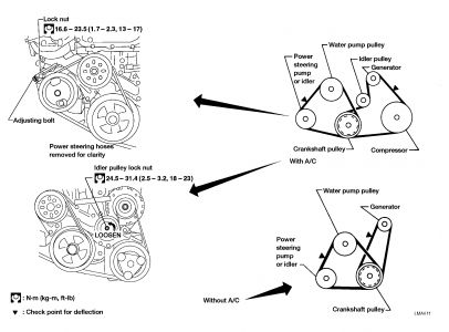

I am putting new belts on can not find the lock bolt on the front belt if there is one. Also in laymen terms how tight should the belts be?

I assume that you have QG18DE. QR25DE should also be very similar.
https://www.2carpros.com/forum/automotive_pictures/55316_06sentrabelt_1.jpg
