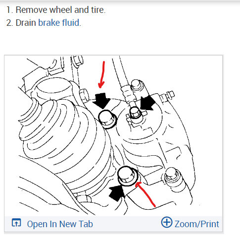

When the brakes are applied I hear a rumbling or knocking sound under the car.

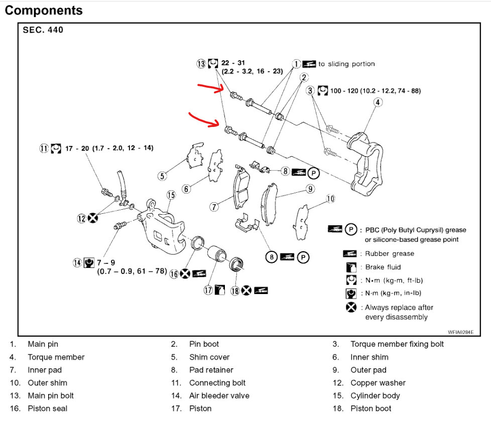

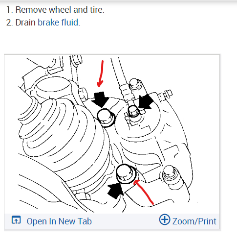

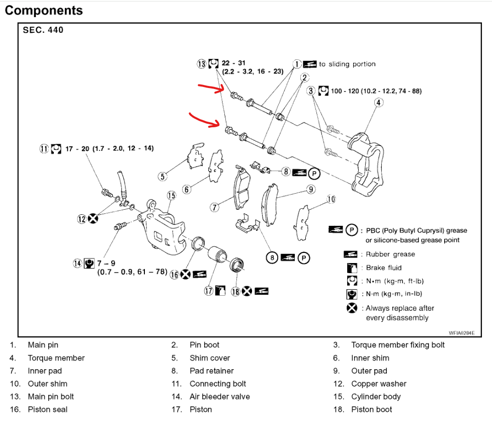

I agree with MHPAUTOS, is sounds like one of the brake calipers is loose, please raise the car up and use a flashlight to inspect he caliper mounting bolts, here is what I am talking about. Check out the images (below). Please let us know what happens.
