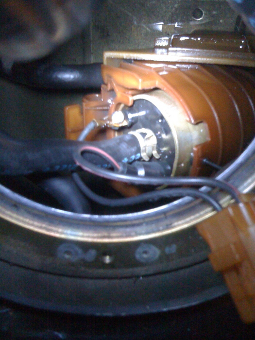

I have gotten down to the fuel pump in a 1996 Nissan Sentra, but cannot find the clip that releases the assembly. I have taken out the float and can access the pump, but cannot seem to release it to remove it. Any suggestions? A picture would be great.
Thanks.

  • 75,992 POSTS
REMOVAL
1.Release fuel pressure.
2.Remove inspection hole cover located under the rear seat.
3.Disconnect fuel supply tube, return tube and electrical connectors.
4.Remove the six screws.
5.Disconnect fuel tubes and connector, then remove fuel gauge assembly.
6.Remove fuel pump with chamber.
*Pull up the front of the chamber.
*Slide chamber forward.
7.Remove fuel pump from chamber.
INSTALLATION
To install, reverse the removal procedure.
CAUTION:
*Tighten bolts to specified torque.
2.0 - 2.5 Nm (0.20 - 0.26 kg-m, 17.4 - 22.6 in-lb)
*Always replace O-ring with a new one.
*After installation, run engine and check for leaks at connections.
Aug 8, 2020 at 5:46 AM (Merged)
DRNUKE
Thanks rasmataz. I've tried this but with no luck. The chamber is held in place by something. I'm afraid to use too much force for fear of snapping something off. The attached photo is what I am looking at - "front" is on the left.
DRNUKE
I was able to get it out there is a clip at the top, on the rear end of the chamber.
Thanks again.
