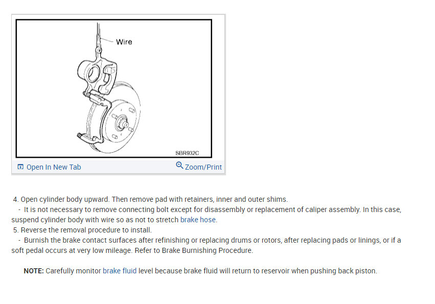

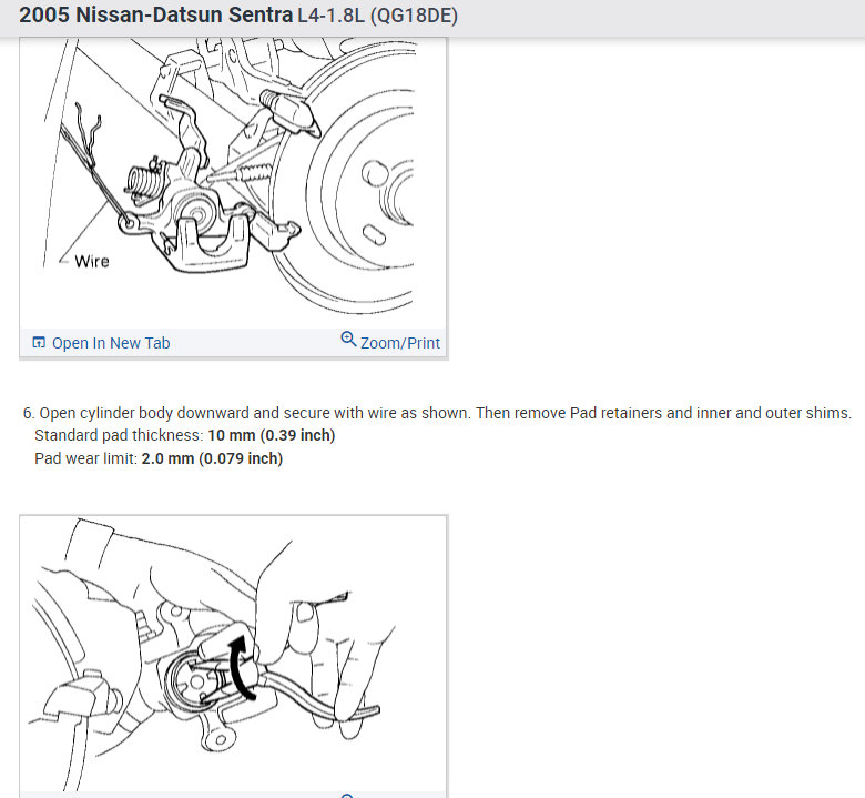

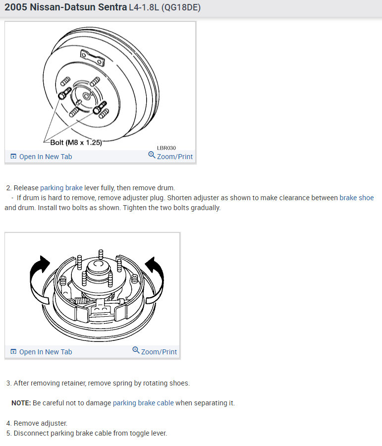

My brother was going to change my back brakes over the weekend but couldn't figure out how to do them. He has changed many back brakes before but apparently was having some difficulities on the "back" of the brakes finding the tension release place. Do you have a diagram of how to replace brake shoes and brake pads on a 2005 Nissan Sentra???
(My car could be a 4 wheel drive...someone told me it is probably a 2 wheel drive...i don't know if this makes a differance or not)

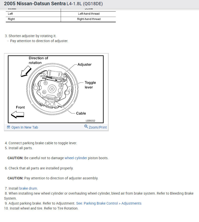

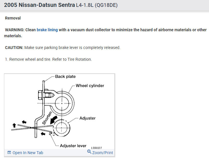

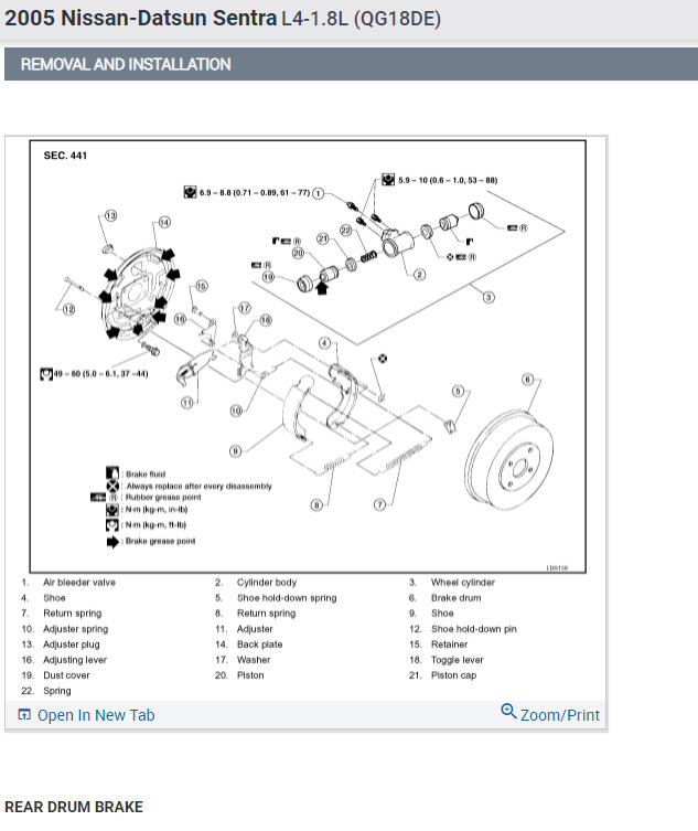

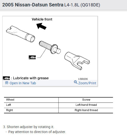

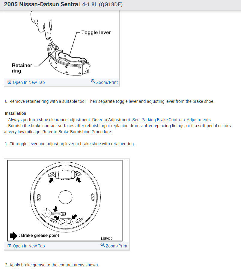

4wd was not an option on this vehicle. Make sure the emergency brake is released. I checked Alldata and I don't see anything unusual about these shoes. once you have removed the drum, remove the retainer springs from the shoes, you'll need a special tool to do this. If your brother has done brake jobs before he should have this tool. then rotate the shoes back and forth and they should pull out easily. this tutorial explains the process thoroughly: https://www.2carpros.com/how_to/rear_brake_shoes.htm

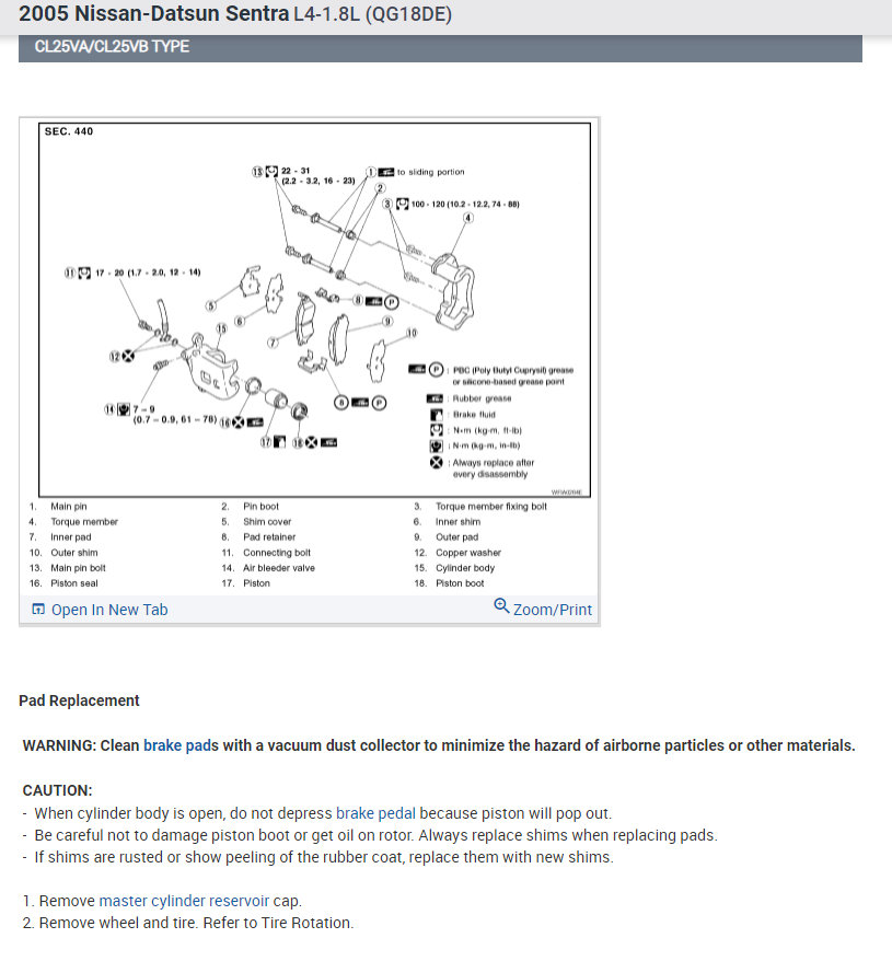

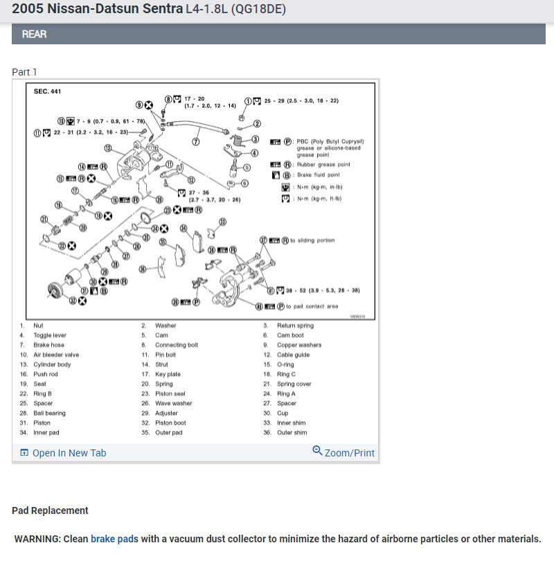

SQM
  • 6,383 POSTS

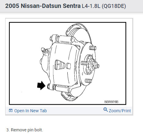

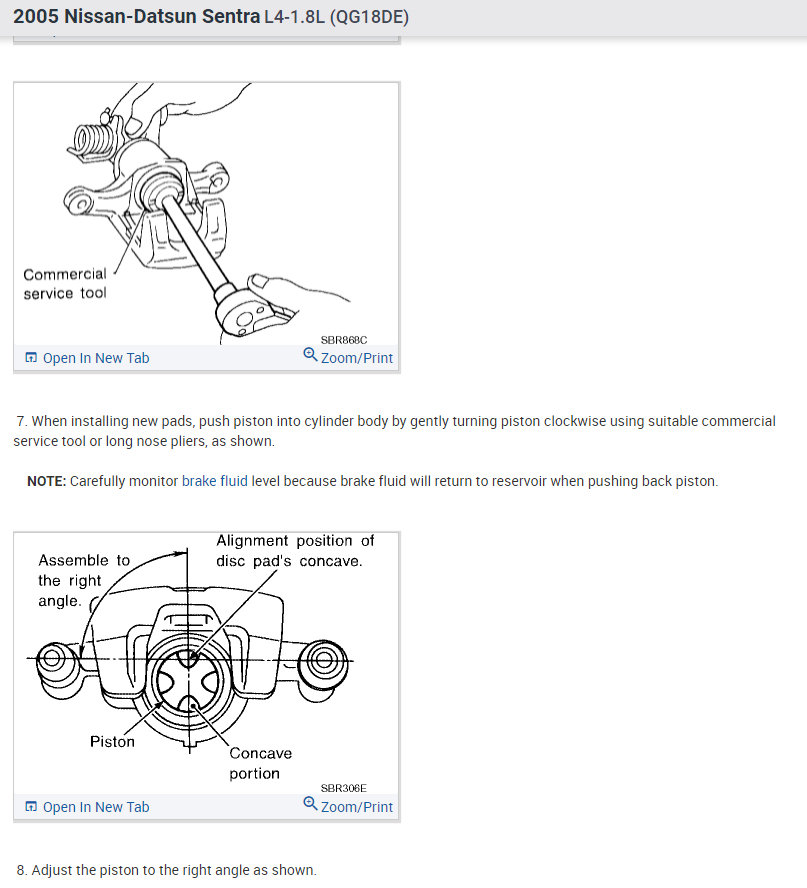

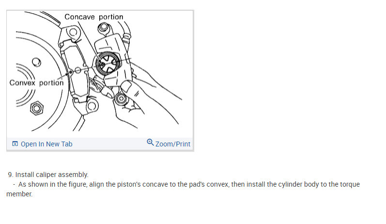

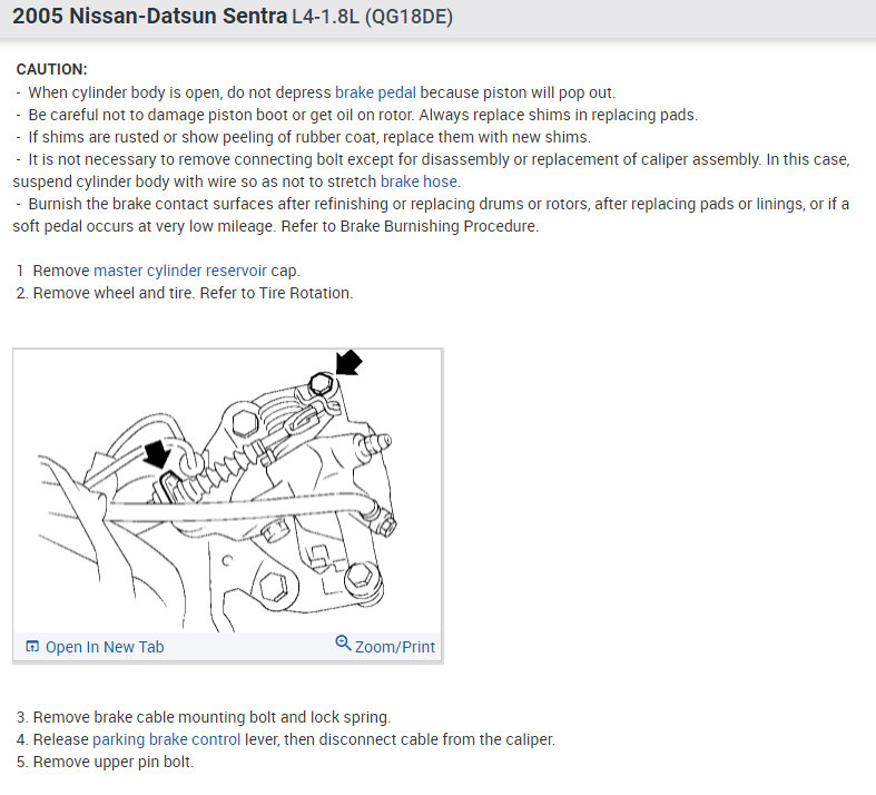

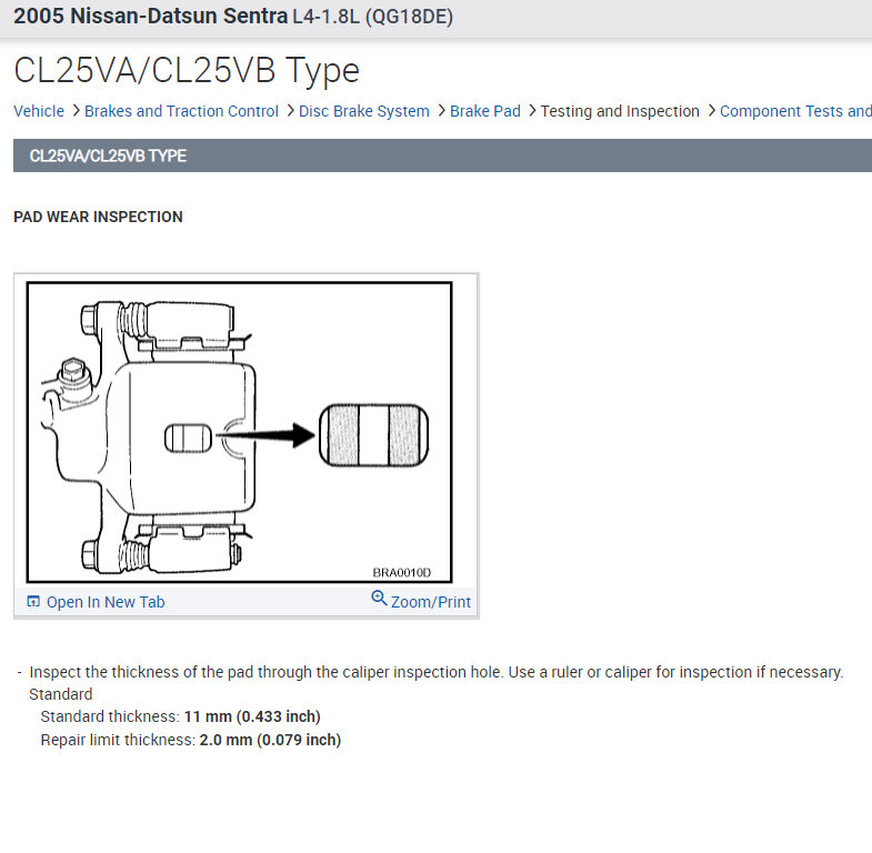

I have attached the complete front and rear brake pad and shoes replacement instructions, along with the optional rear brake pads instructions, for anyone who might be doing the same job.
https://www.2carpros.com/articles/how-to-replace-rear-brake-shoes-and-drums
Any questions, please feel free to let us know.
