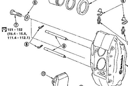

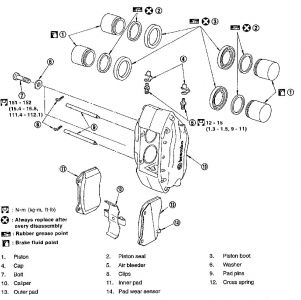

i have a sentra ser spec-v with the brembo brakes what are the correct torque specs for mounting the calipers

Can't really see them. N.m (Kg-m, ft-lb)
