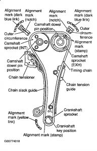

i need to know how the dowel pins line up on the cam shafts for the timing chain
