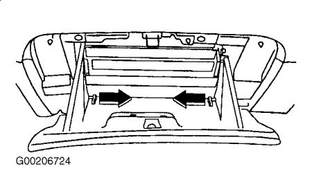

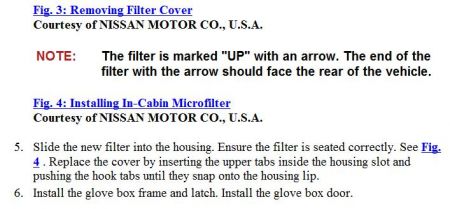

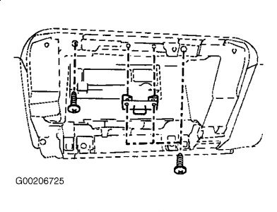

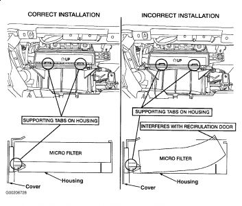

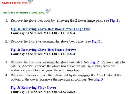

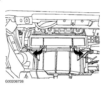

I was wondering if it was pretty easy to install the cabin filter for my nissan sentra 04....anyone know instructions on how to?
