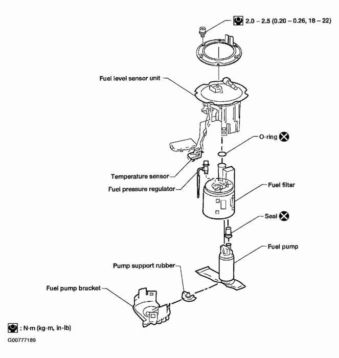

Engine turns over but will not start. Like there is no gas.
Friday, May 28th, 2010 AT 6:48 PM
19 Replies
  • 75,992 POSTS
Lets do below for a start to determine if its fuel or spark related issue and get back asap.
Get a helper disconnect a spark plug wire or 2 and ground it to the engine at least 3/16 away from ground-have helper crank engine over-do you have a snapping blue spark? If so-you have a fuel related problem, check the fuel pressure to rule out the fuel filter/fuel pump/pressure regulator and listen to the injector/s are they pulsing or hook up a noid light. No snapping blue spark continue to troubleshoot the ignition system-power input to the coil/coil packs,coil's resistances,distributor pick-up coil, ignition control module, cam and crank sensors and computer Note: If it doesn't apply disregard it

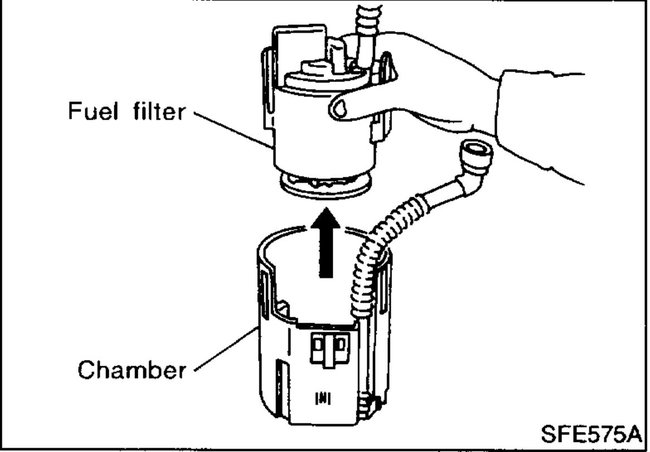

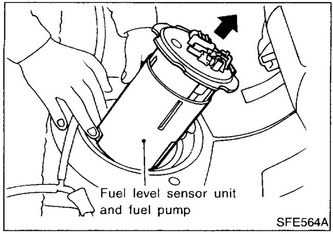

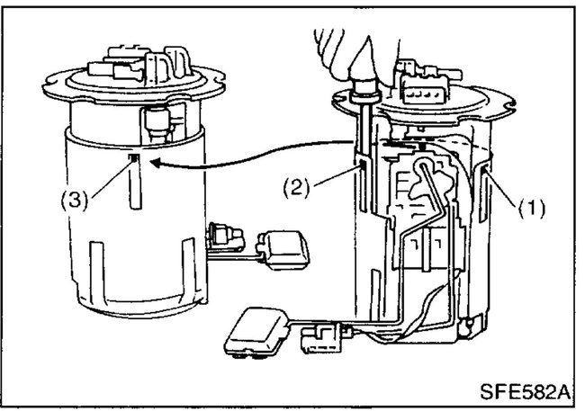

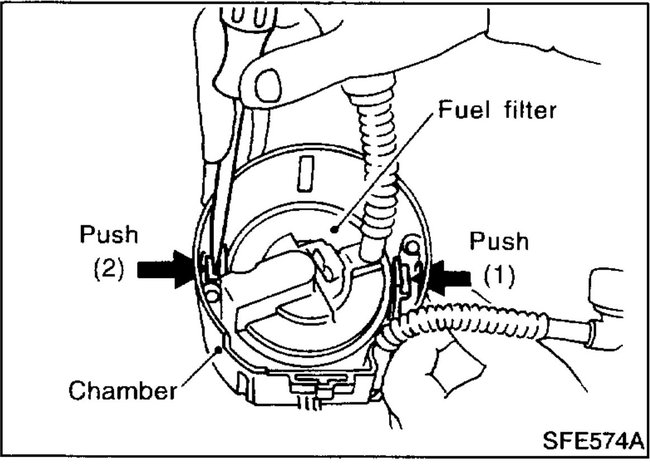

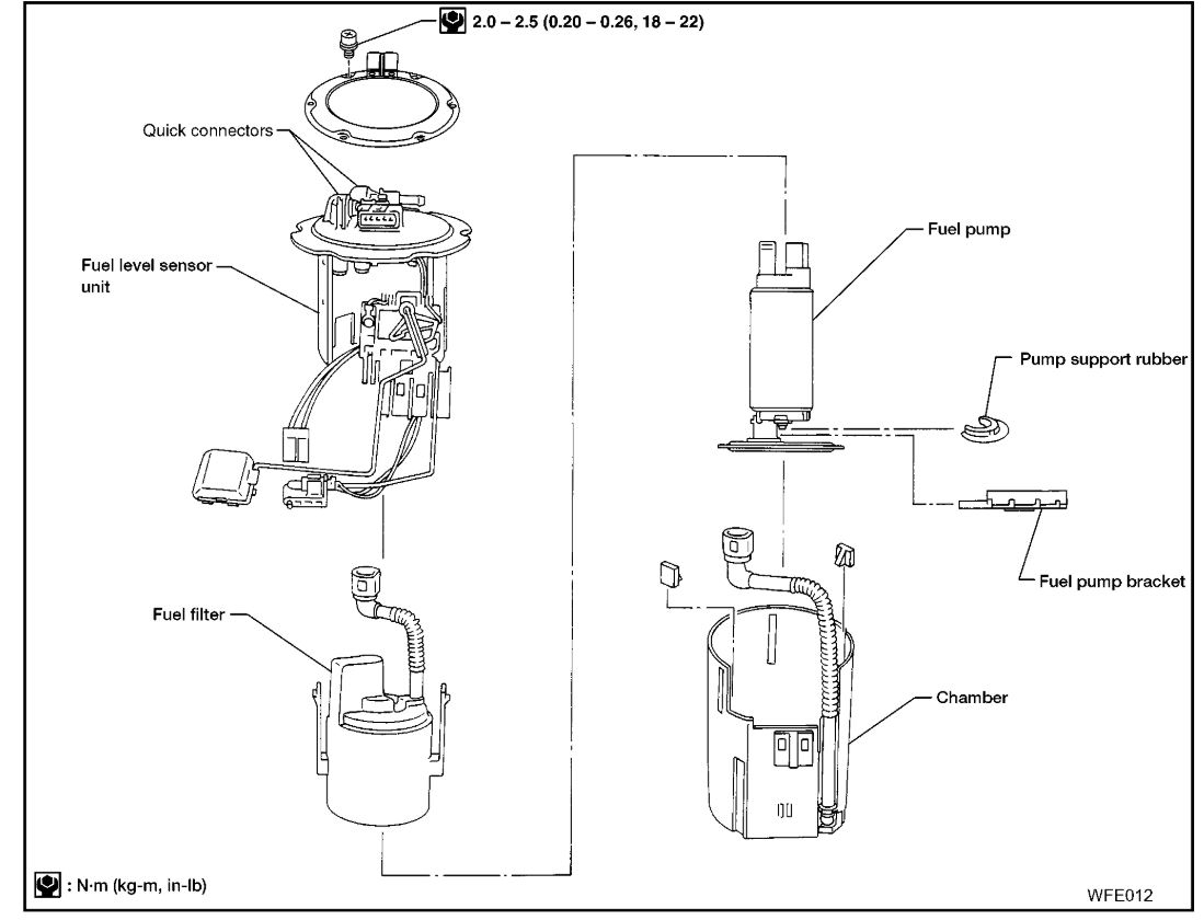

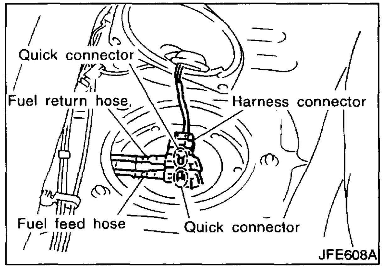

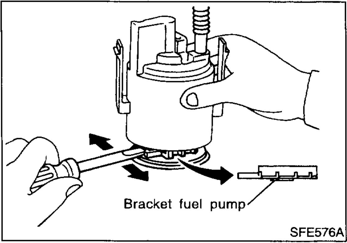

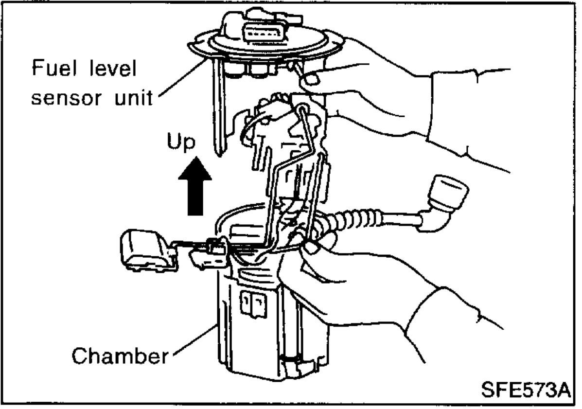

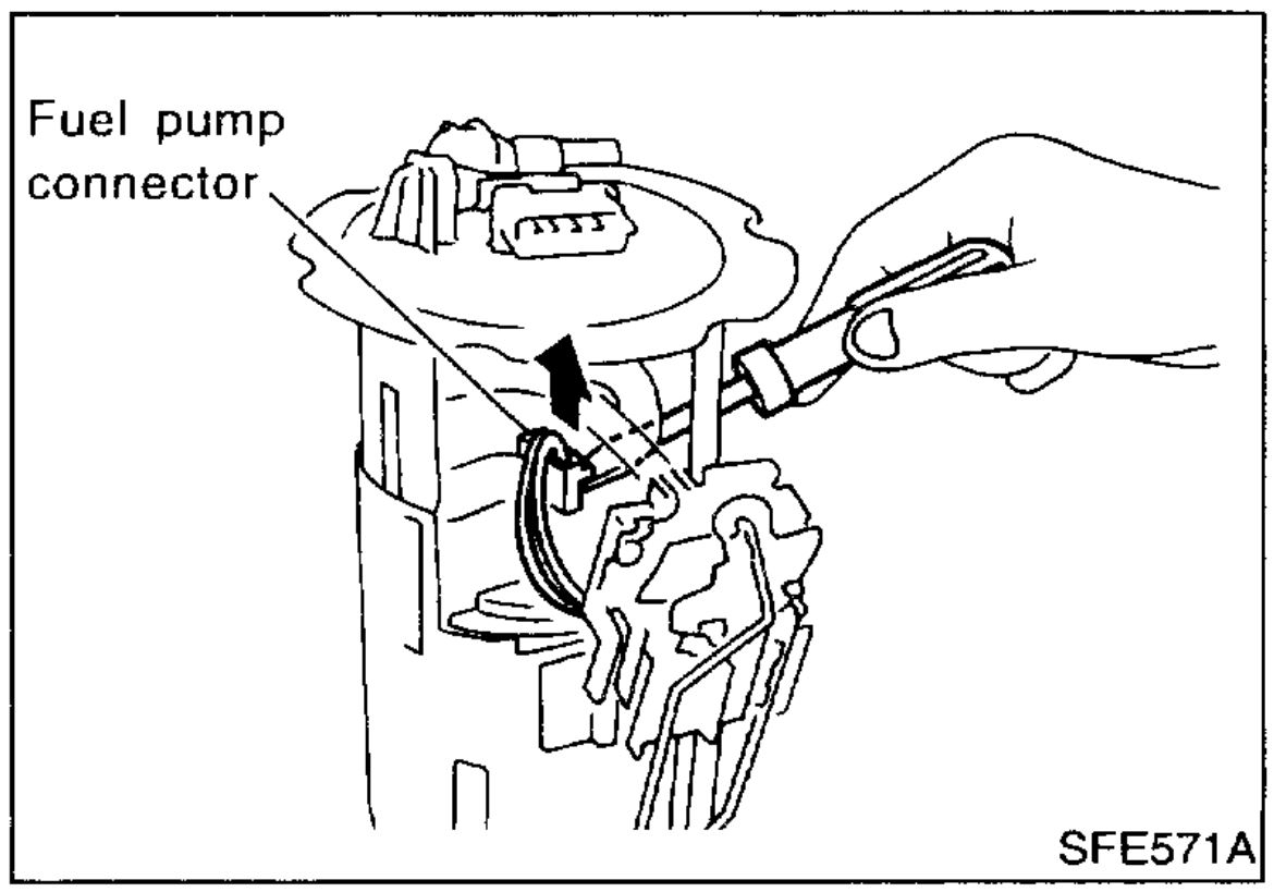

Fuel filter is in the fuel tank- part of the pump assembly. See diagrams below for changing it

I was wondering where the fuel filter is on a 2002 nissan sentra gxe 1.8 I keep getting mixed answers like I need to replace the fuel pump, there is no filter, its on the back of the engine, or its in the middle of the car where the fuel lines run
+3
Wednesday, January 9th, 2019 AT 5:28 PM (Merged)
WRENCHTECH
  • 20,761 POSTS
This car does not have a serviceable fuel filter. The only one it has is built into the fuel pump assembly and is not serviced as maintenance.

The fuel filter is located inside the fuel tank

Filter is in tank generaly not replaced until pump failure comes as a unit
+3
Wednesday, January 9th, 2019 AT 5:29 PM (Merged)
RACEFAN966
  • 5,029 POSTS
It is true no fuel filter that can be replaced. It is not servicable. It is part of the fuel pump in the tank.
+2
JDL
  • 16,098 POSTS
My info shows the fuel filter is part of fuel pump assembly. Don't know if you can replace separately from pump? Online partsbook didn't show separate fuel filter?

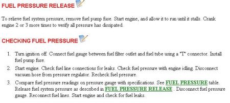

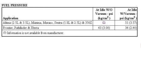

Hard to start car early in morning. Turn key over and over and finally crank. Checked spart plugs and they were drenched with fuel. Is it the fuel pump? I am desperate.
ZACKMAN
  • 4,202 POSTS

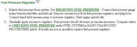

If the plugs are drenched with fuel, it shows that you have fuel, so the pump is working. But the system may not maintain the fuel at the proper pressure.
Before you change any of the parts, I would get the fuel pressure tested at the rail. If it s losing pressure, replace the fuel pressure regulator.

How do you test the pressure at the rail on my 2003 nissan sentra.
+1
ZACKMAN
  • 4,202 POSTS
You will need a fuel pressure gauge to do this test, such as Actron CP7818
