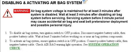

i took apart my stering panel to see if i could change out my ignition switch, but dont know if any air bags will deploy if i mess with column, how can i change out ignition switch with care?
