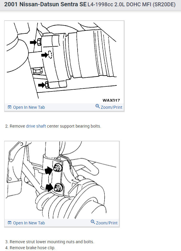

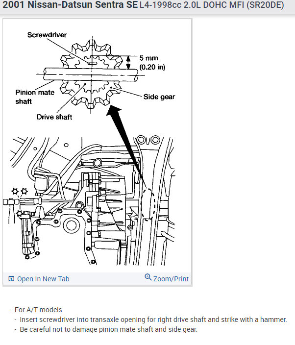

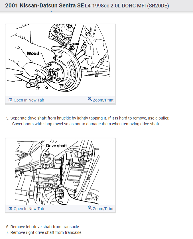

how do you change out cv joints for a nissan sentra 2.0 2001?
May 30, 2008 at 4:51 AM
SQM
  • CAR REPAIR CONTRIBUTOR
  • 6,383 POSTS

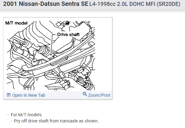

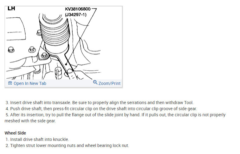

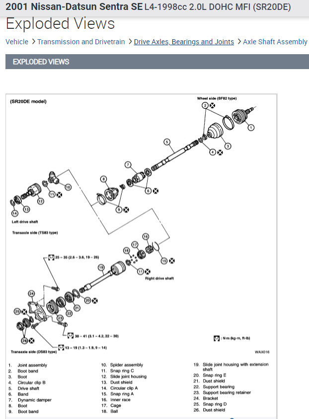

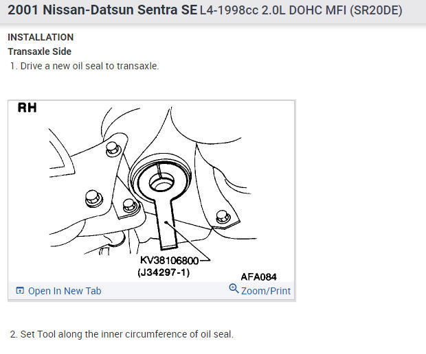

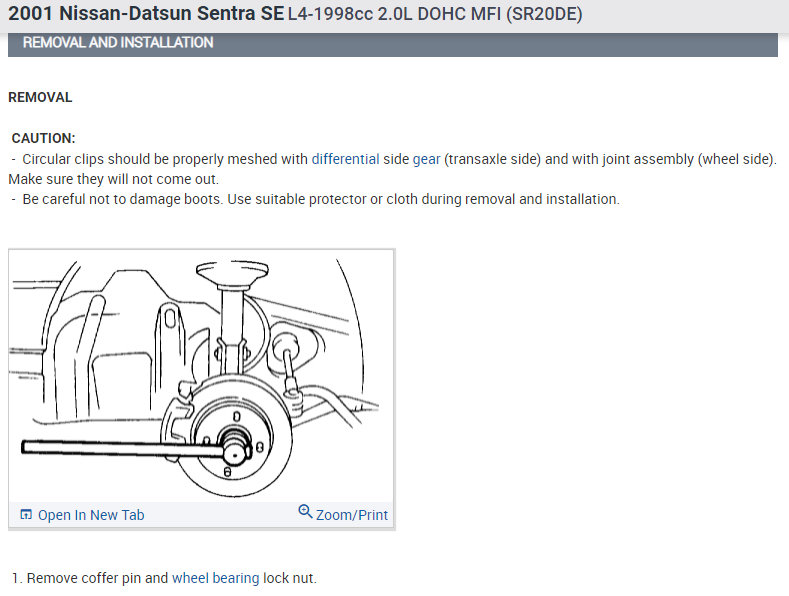

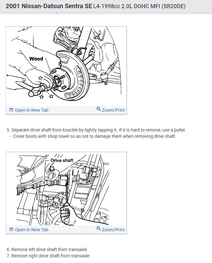

In order to change the CV axle you will have to first raise the vehicle and support it with jack stands.
Then remove the wheel.
Remove the axle nut cotter pin and the nut.
Then you will have to disconnect the ball joint, which will allow you to remove the CV axle.
Here is a helpful article:
https://www.2carpros.com/articles/replace-cv-axle
https://youtu.be/vOVpWpXsJfk
