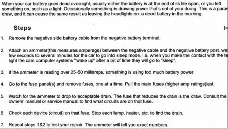

Put a brand new battery into my car and overnight something seems to drain the battery completely. What could be my problem?
