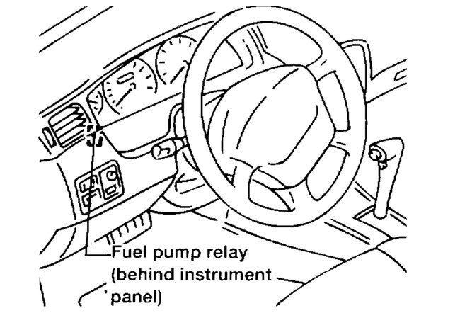

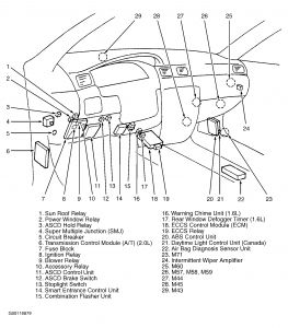

I cannot find the fuel pump relay. I checked under the hood I cannot find it.

I am sorry that that nissanforum.com and nicoclub.com could not hep you. Anyway, your fuel pump relay is not behind the radio, rather it is behind the left side of the dash (diagrams below).
My understanding is that you could hear your fuel pump turning on, right? If you could, your relay is probably be okay.
Do me a favor. When you finish check the relay, check the EGR valve for me. GA16 has a tendency for plugged up EGR valve which will cause not starting. Try that.
Here's a guide on testing relays, it will help
See the diagram below for the location of the fuel pump relay. Check out the diagrams (Below). Please let us know if you need anything else to get the problem fixed.

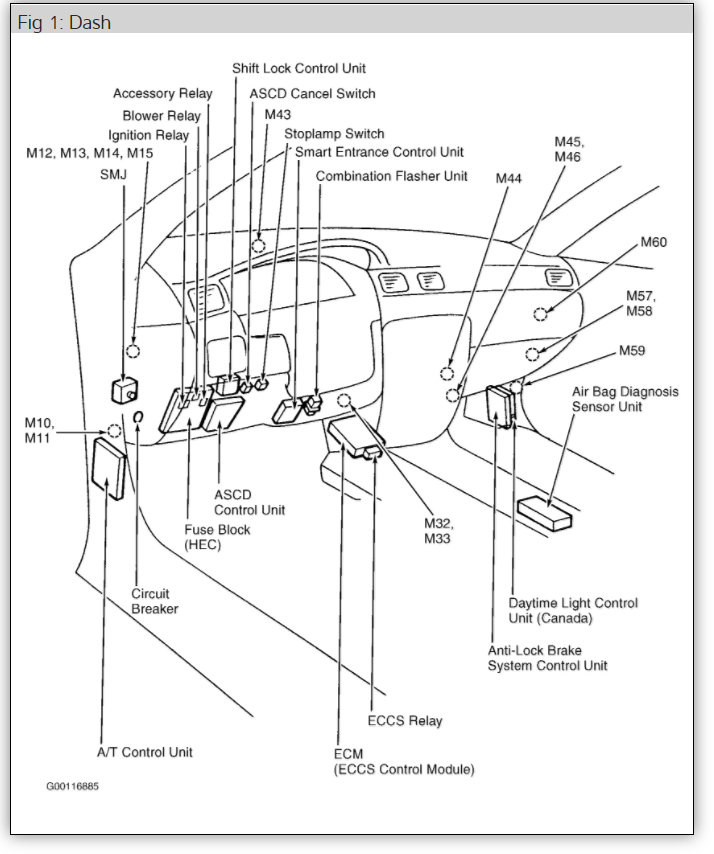

I tried to start the car today I could not hear the fuel pump working anymore. I will try looking for that relay. is it somewhere behind the gauge cluster?

I believe it is behind the cluster. I have a 1995, so mine is under the hood. But for 1999, the description was "behind left side of dash". It is probably close to M43 ground #29.
https://images.2carpros.com/forum/automotive_pictures/55316_Sentra_dash_1.jpg

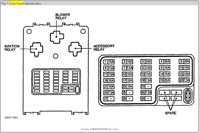

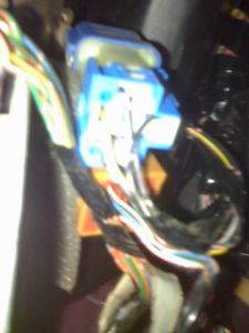

I looked behind the gauge cluster,found nothing. The only relays I found under the dash were these.
https://images.2carpros.com/forum/automotive_pictures/262361_2faa09805efc_1.jpg

Ok, within those two panels, which relay? Can someone provide a picture or a drawing?
I have found the panels, but which relay am I looking at, basically I have seven to choose from.

Here is the fuel pump relay location and a guide to help you test it. It is at the left side if the dash f10

The fuel pump relay is behind the left side of dash-cannot provide the exact location its unavailable
