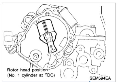

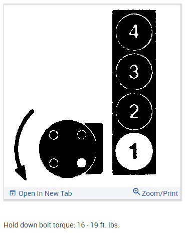

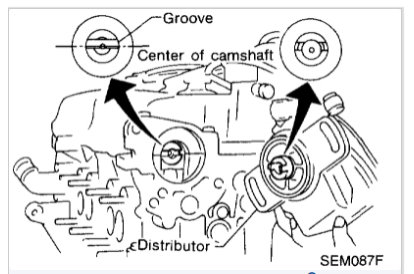

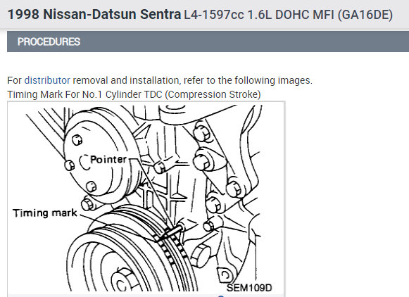

Could someone PLEASE tell me whether the ignition module is bulit-in to this car's distributor or it is a separate part................I have been quoted a rather high price to replace the distributor and a friend of mine (who is unfortuantely 2,000 miles away who is a mechanic believes it is only the ignition module). I have spoken to another mechanic in MA - and although he is not familiar with the car also thinks it might only be the ignition module - armed with this I called the mechanic back at the shop the car had been towed to and he insists that the ignition module is integrated into the distributor.

Here is the information you requested. yes, you're correct. The ignition module is built into the distributor. I've attached picture steps below on how to remove and replace the distributor on your car. Hope this helps and thanks for using 2CarPros.
