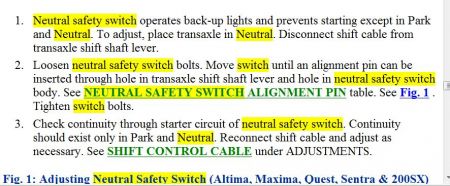

1997 Nissan Sentra nuetral fail switch

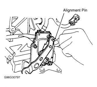

where is the nuetral fail switch located

See text for location and adjustment of switch, it is located on the transmission at the selector.
