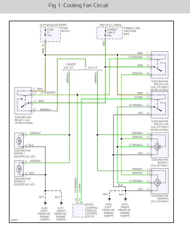

I am having trouble with the wiring for the radiator fan. Does anyone have a wiring diagram that I could look at for help?
Thanks

This guide will help using the cooling fan wiring diagrams below.

Do you have power at the fan? Here is a guide that will help also check out the fan wiring diagrams in the post above:
