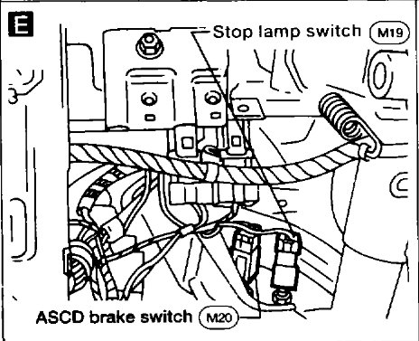

how do you put on a brake switch for a 1997 nissan sentra gxe?

Follow the brake pedal arm till it meets the brake support bracket. Disconnect the wiring connector and then unbolt the switch. Here is a diagram to help you see how.
