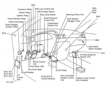

Electrical problem
1997 Nissan Sentra 4 cyl Front Wheel Drive Automatic
I can't locate the fan blower resistor. The 1,2&3 speeds on the fan don't work however the 4th speed works. I have located the fan motor and traced the wire from the fan until it dissappears. I asum it needs a new resistor but I am unablet locate it.
Can you tell me where it is.
