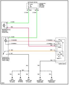

1995 Nissan Sentra Washer Fluid Tank Will Not Turn Off
1995 NISSAN SENTRA
97,000 MILES • 4 CYL • FWD • AUTOMATIC
MELVINBATES
While driving my windshield washer fluid started spraying and continued until empty, yet the motor just continued to run. Then the wipers came on and could not be turned off. Is the problem a relay switch?
Apr 7, 2010 at 10:44 AM
SERVICE WRITER
  • 9,123 POSTS
Based on the wiring diagram there is no relay. The common thread is the wiper switch.
https://images.2carpros.com/forum/automotive_pictures/30961_Image1_7.jpg
