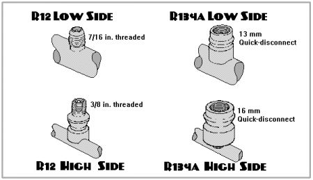

just bought a '95 sentra. i want to charge the ac. do i need an adaptor kit, does this year still use the old refrigerant? how do i tell if it's been modified?

Yours should be the R134a system also by the size of the fittings -See below
https://images.2carpros.com/forum/automotive_pictures/12900_ac_service_fittings_3.jpg
