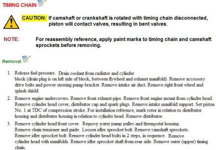

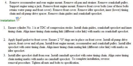

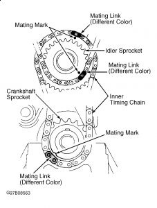

1995 Nissan Sentra chain timing
BADONG
MEMBER
1995 NISSAN SENTRA
Engine Performance problem
1995 Nissan Sentra 4 cyl Two Wheel Drive Manual
how to change chain timing
Tuesday, February 16th, 2010 AT 5:49 AM
BLUELIGHTNIN6
MECHANIC
16,542 POSTS
SPONSORED LINKS
+2
Tuesday, February 16th, 2010 AT 10:12 AM
