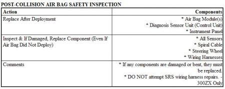

I am replacing my air bags due to some front end dammage. I need to make sure that I'm replacing everything. I replaced both air bags, the controller and the clock spring. Is there anything else that I'm missing? Thanks

If you have installed the spiral cable, air bag module and air bags then you have installed everything.
