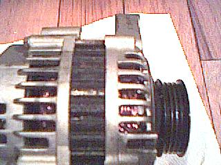

Okay, after seeing a guy at Autozone (as my car sputtered and died... How lucky, huh?) I ran an idea by him. . . Someone at work said that maybe a fusible link had went. . . After checking the fusible links box located right next to the battery compartment everything seemed ship-shape. . . In my fusebox on the interior of the car I checked a fuse that's labeled as battery and it wasn't blown. . .
Okay, back to the alternator. . .

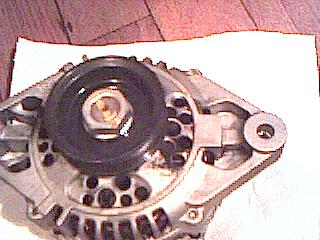

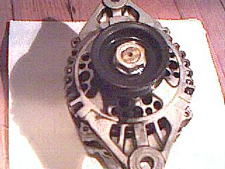

So he points out some black residue / powder located on the side of the belt for the alt. They line up with vent holes coming from the interior. I've included 3 pictures that I've taken of the alternator. I plan on swapping it out tomorrow for a new one and giving it a shot. If anyone has any suggestions, ideas, or advice I'm all ears!
https://www.2carpros.com/forum/automotive_pictures/236105_Image1_1.jpg
This image is how it would sit in a car (bottom portion is the base), wire connections located on opposite side. Notice the black residue located down from the wheel. The camera I used isn't the best, but that material does go into those circular holes. None of this residue was observed on the wheel on the vent holes on the opposite side.
https://www.2carpros.com/forum/automotive_pictures/236105_Image2_1.jpg
https://www.2carpros.com/forum/automotive_pictures/236105_Image3_1.jpg
Having seen these three pictures, what advice is there to learn about this alternator? ... Do you think the alt is faulty? Is the residue evidence of a different problem? Is it time to put the car out to pasture?

MHPAUTOS
  • 31,937 POSTS
Hi there,
I feel that that alternator has suffered a internal short and it may well be the cause of your problems. Fit the new alternator and post your results.

ANDREWHART
  • 6 POSTS
I took it into Autozone and they ran their testing diagnostics. The machine said it failed all 3 of the tests they conduct on it, so I got a new alt (which I demanded they test prior to me leaving the store). Machine said it read good, so I took it back home to my car.
A friend of mine who know's his way around an engine helped to install this one, we put it out on the road tonight for about 20 minutes of city driving and the light hasn't come on (yet, not letting my guard down that quickly!).
