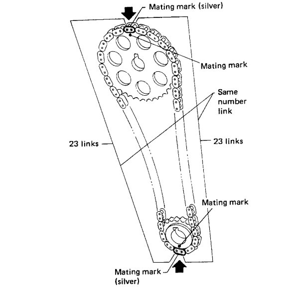

It honestly sounds like I hear a knocking. Any smoke from the exhaust? Any coolant usage? What was done to the head? Also, are you certain you have the timing right?
If you could, let me know what was done to the head and if it was removed completely.
Friday, August 28th, 2020 AT 9:50 AM (Merged)

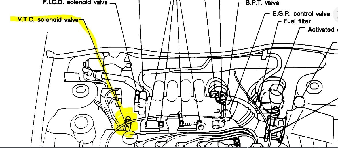

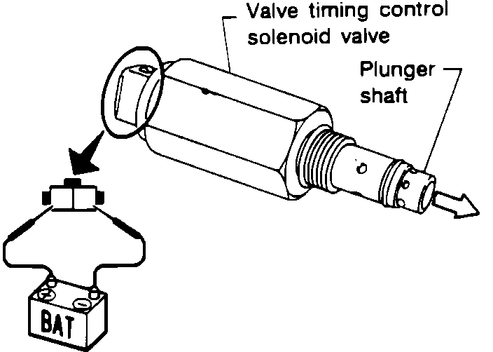

Are you confident about the timing? Also, did you replace the variable valve timing control solenoid?
I attached two pics. The first shows the VTC solenoid location. The second shows how to check one. Here are the directions for testing:
__________________
1. Disconnect the solenoid connector.
2. Apply battery voltage to the terminals as shown.
3. The solenoid should make a clicking sound when voltage is applied and released.
4. Make sure that the plunger shaft protrudes.
Replace the solenoid if it fails the above test.
_______________

Thanks a lot. Well the timing I want to say yes I feel confident, but I'm not certain maybe 98%. I did three times I believe and no I didn't replace the valve it failed. So I'm going to replace I'll let you know what happened.
