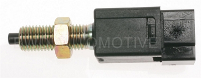

i went and purchased a break light switch for my nissan sentra, it is the BWD part # S6027, and although it seems easy, i can't figure out how to mount it. help

At the top of the brake pedal: * Remove the wiring connector at the switch (the black part) * Remove the switch lock nut * Remove the switch from the pedal assembly * Install and adjust the switch
