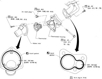

Hi, im trying to locate the position of the thermostat in a 1989-1990 Nissan Sentra. I have looked where the housing leading up to the engine is and its not there? Could you please tell me where it is so i can replace it please.

it is on the left hand side of the engine, on the firewall side.

thanks for that, do you know where i can go to get an engine picture for this car model. I really dont know anything about cars.cheers

https://images.2carpros.com/forum/automotive_pictures/261618_0900c152801ce2f3_1.jpg
