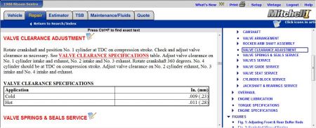

1988 Nissan Sentra specs on lifters
1988 NISSAN SENTRA
177,200 MILES • 4 CYL • FWD • MANUAL
NICK MO
trying to adjust lifters
Apr 11, 2010 at 12:37 AM
  • 75,992 POSTS
See below
https://images.2carpros.com/forum/automotive_pictures/12900_lifters_1.jpg
