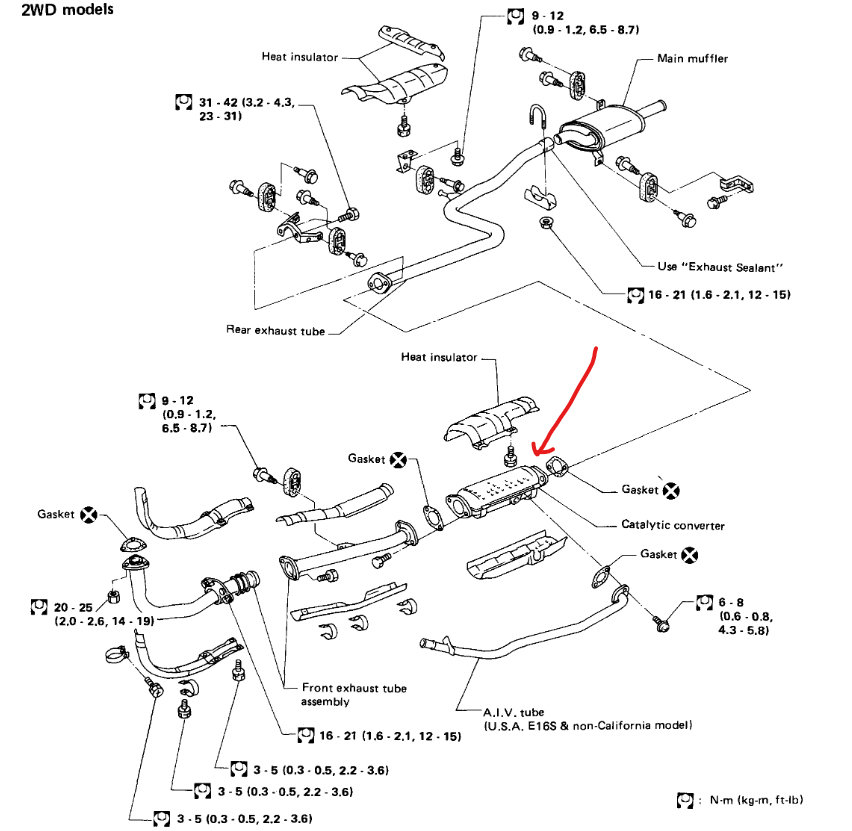

To me it sounds like you have a clogged catalytic converter but to be sure this guide can help you test it.
This guide can help explain as well about engine hesitation
