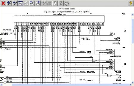

I just purchaced this vehicle knowing the problem.The computer was cleared of faults.I took it out for a test drive,and the car bucked violently.The computer flashed out a"airflow meter/ground circuit".I noticed that someone before me added a ground wire into the airflow meter wiring harness. I cleaned and replaced the engine compartment grounds,that I could find,then tested the airflow meter both in and out of the car,the meter is OK.
It seems as though computer is not recieving the signal from theairflow sensor

You will have to start with back probing the air flow meter pins back to the ECU, check for continuity and high resistance, start here.

I need the wiring diagram from the ECU to the airflow meter
re;1988 nissan sentra 1.6litter TBI FWD Sedan

He has access to Mitchell 1 this is our reference data site, i have lost access for some reason, i have Emailed him to send you the information.He normally comes on line a few times every day.

Give me your email addy-sending it here -it'll be blurry/unreadable.
https://images.2carpros.com/forum/automotive_pictures/12900_mas_airflow_1.jpg

The diagram came through my e-mail !
Give me a few days,and I will diagnose the wiring harness.

Now I have tested the air flow meter,and the wiring harness.The harness wires all had the same resistance.What do you sugest doing next?

If all is OK in the loom, i feel it is time to get the ECU tested, you may be getting an internal fault there.
