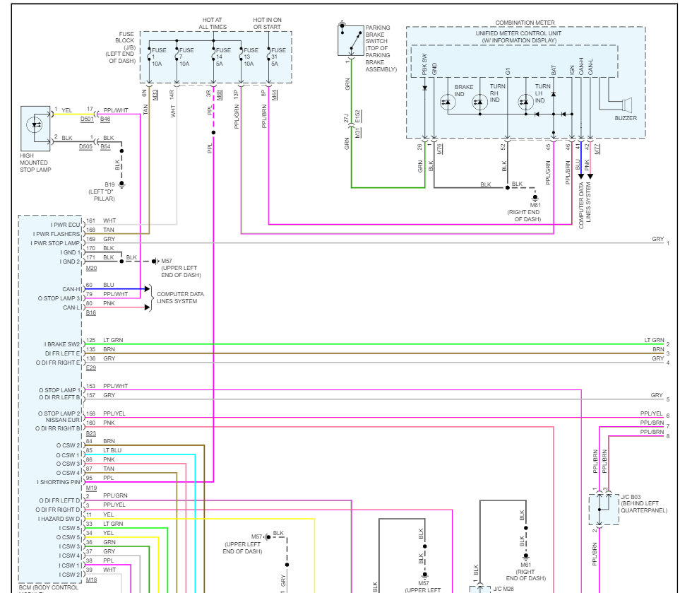

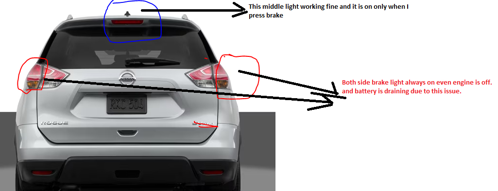

I have a weird issue that started a few days ago. Brake Light on both sides is always on even when I switch off the engine.
Read Top Center Brake Light working fine and only on when I press the brake.
So, I checked the Brake Light switch, and it is working based center brake is on when I pressed brake.
Do you think there could be ground issues with both sides of the brake lights?
Currently I can't get it through inspection due to always on lights.

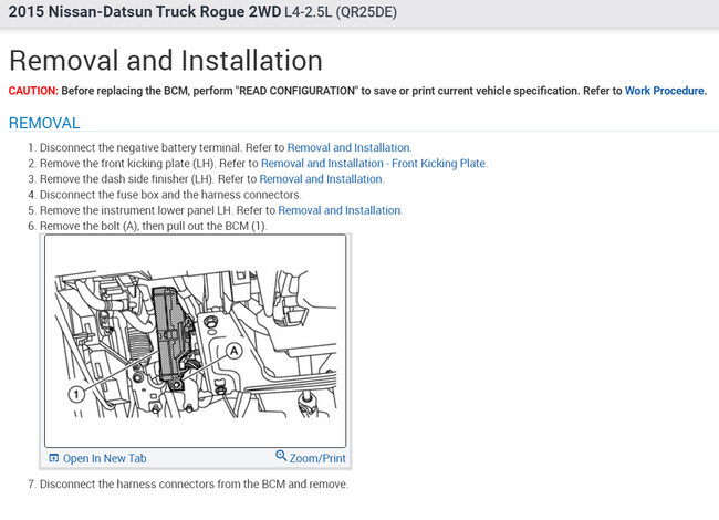

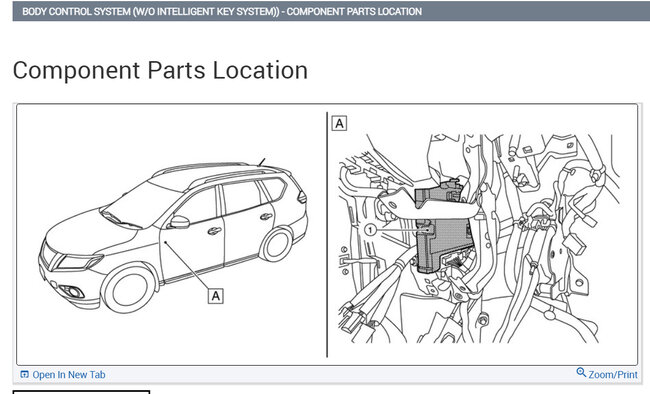

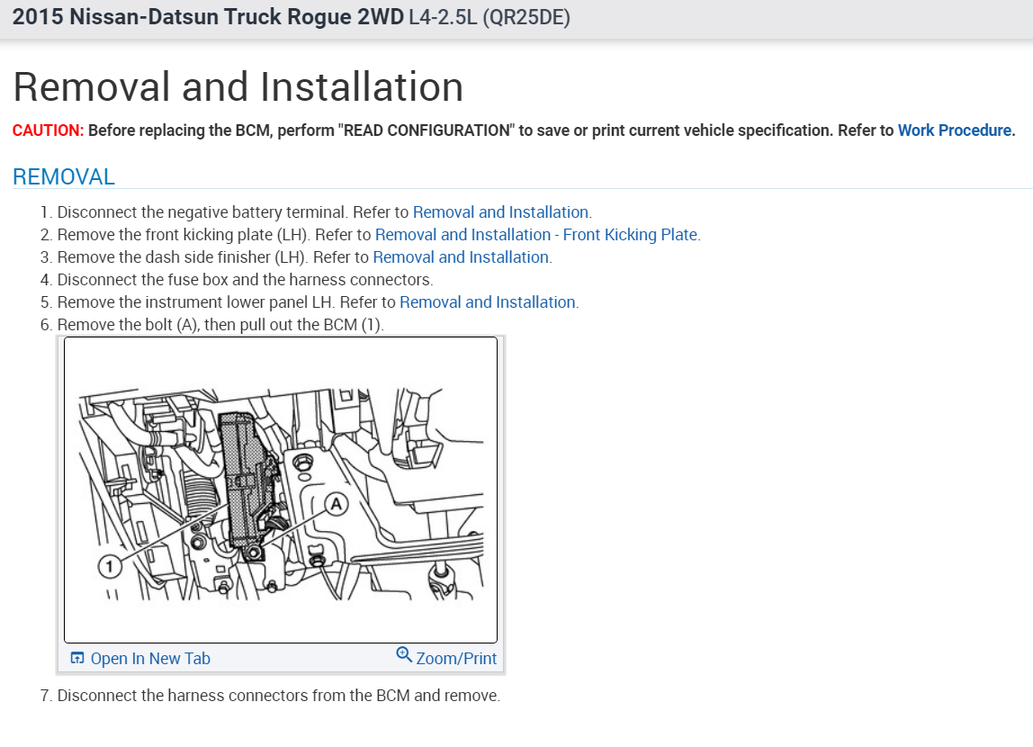

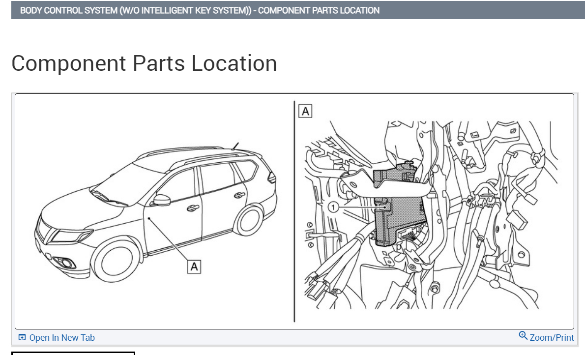

It sounds like the BCM has gone out. But to be sure, you can get a CAN scanner (Controller Area Network) which will work on most cars from Amazon.
https://youtu.be/u-4syLc-ifQ

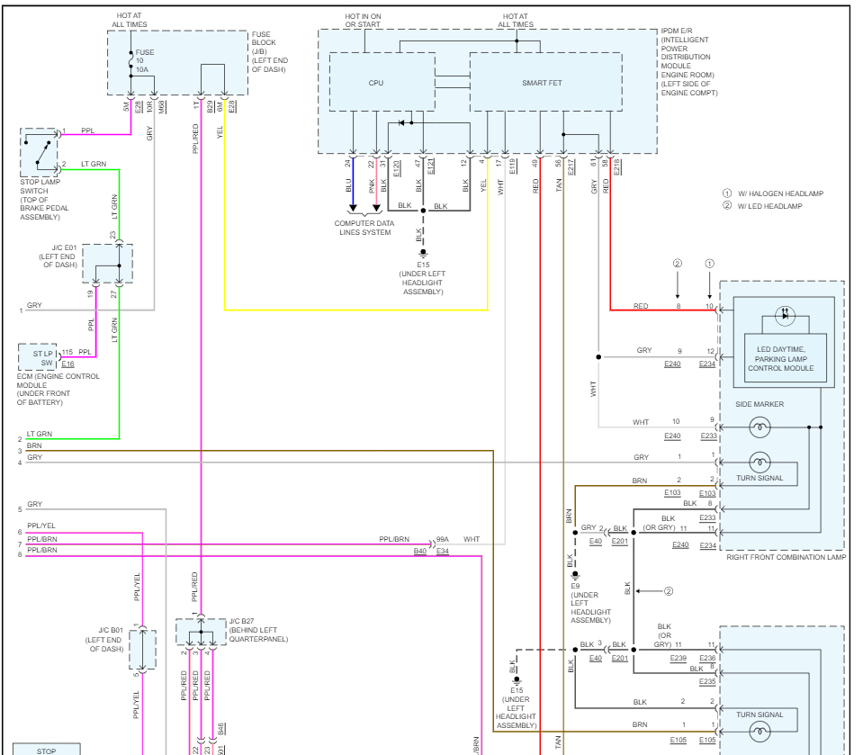

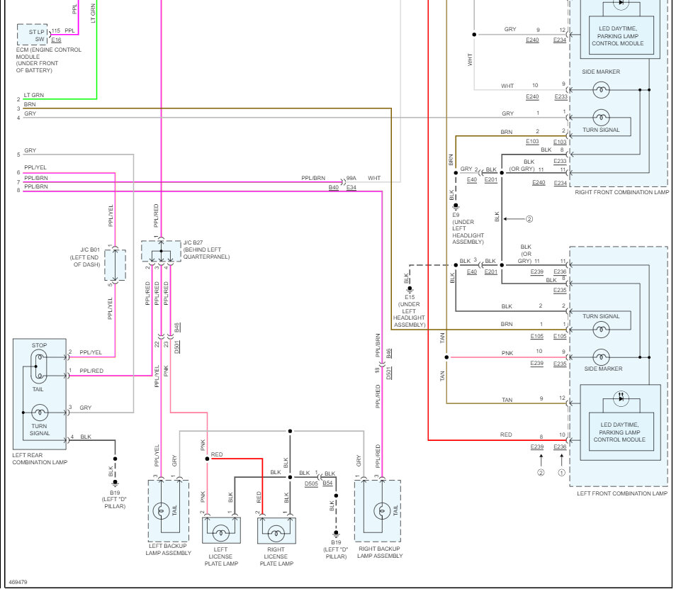

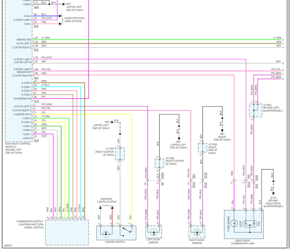

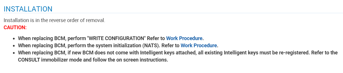

Here is how to change out the BCM, you can get a preprogrammed unit by searching Google or Ebay. Also, I have included the brake light wiring diagrams so you can see how the system works and which fuses to check just in case. Check out the images (below). Please let us know what happens.
Aug 18, 2023 at 11:16 AM

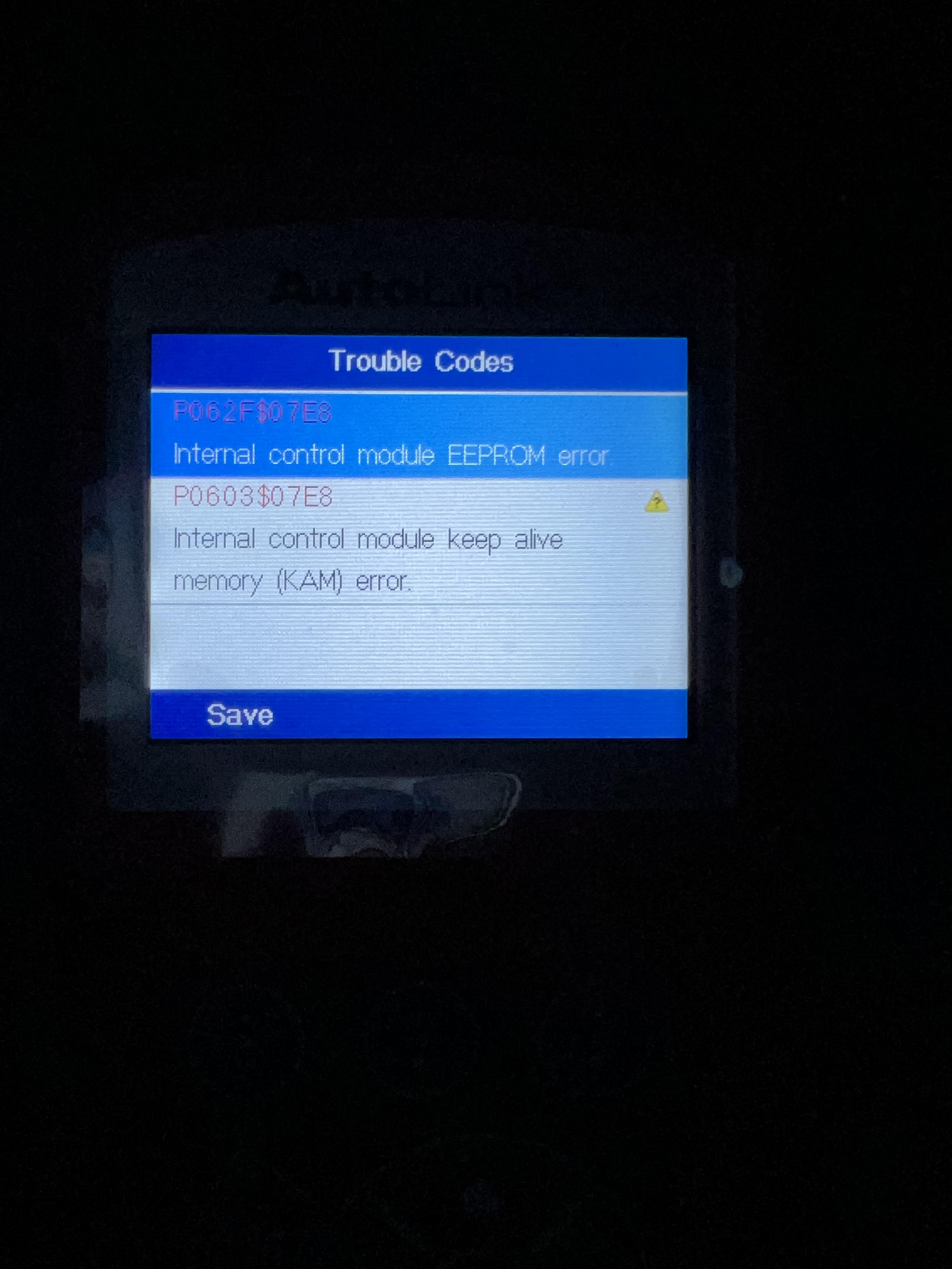

NIVIKAMAL
Dear Ken,
Here is the code I received from CAN:
P062F - Internal Control Module EEPROM
P0603 - Internal Control Module keep alive memory
Aug 20, 2023 at 7:06 AM
  • 54,837 POSTS
Here's a brief explanation of each code:
P062F - Internal Control Module EEPROM:
P0603 - Internal Control Module Keep Alive Memory:
I would go over all fuses in the vehicle with the systems on.
here is a guide to help:

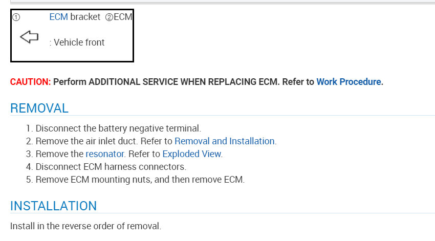

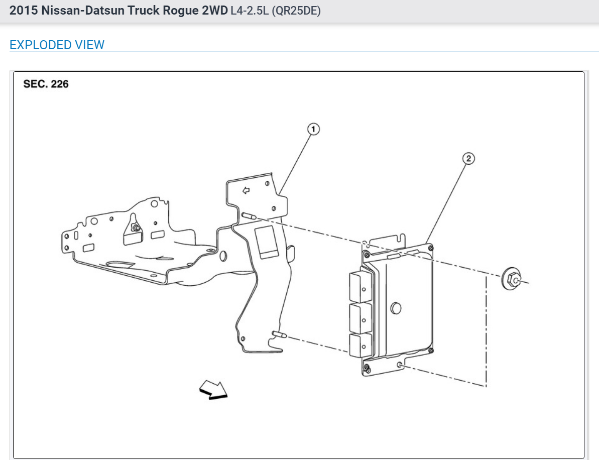

If all fuses are good it sounds like the ECM is having a problem, you can get a preprogrammed unit by searching Google or Ebay.
Here is how to change the ECM out. Check out the images (below). Please let us know what happens.
