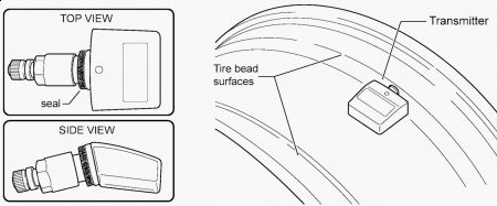

when braking or stopping hard the front tires bounce

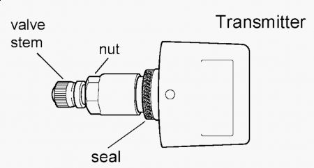

If more than the normal wheel hop of the ABS system, have the struts looked at! There is also a tech bulliten about the low tire pressure transmitters having a slow leak, so check tire pressure if you have this sytem! They replace the seals.
https://images.2carpros.com/forum/automotive_pictures/62217_quest_2.jpg
https://images.2carpros.com/forum/automotive_pictures/62217_questb_1.jpg
If the trouble started after an alignment, it was done wrong. Bulliten states NOT to use the green and red lights on alignment machines! Use specs only.
