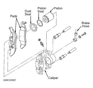

What's your question? is it after replacing parts wheel is still locked?

yes left front lock up replace cal still lock up went one pump of the brake lock up so though cal was bad replace again still lock up . was told that the brake line could be bad so replace it . still the same also was told that the right rear brake line could be bad replace it still the same

When caliper is locked open bleeder does fluid squirt out? also did pins get cleaned and lubed? see diagram
