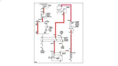

I disconected negative baterry cable and then waited a minute or so and reconnected it.When I tried to start car again(which ,before disconecting negative battery cable would turn over,with compresion,but not start)the indicators on the dash lit up as normal and then went dead.I tried turning the ignition (key) again and the same happened again.I then disconected negative battery cable once again and reconnected.When i tried turning on the key again nothing happened at all.I rechecked the battery cable and all looks as it should.How to I go about trouble shooting this problem?

I am unable to check for ignition spark due to the fact that there is no response of any kind,while turning key to start.The baterry is new and connected.I was able to turn over engine before I disconnected negative battery cable,and now there is no response after reconnecting battery

I want you to check fuse H in the fuse/fusible link box on left front of engine compartment. If okay check and test the inhibitor switch on left side of transaxle and the inhibitor relay in the fuse/fusible link box. Before you do above I want you to short out the red and white wire at the solenoid to the battery terminal on it and tell me what happened. If it cranks the engine over check and test the above itme. See Start EWD:
https://images.2carpros.com/forum/automotive_pictures/12900_charge_EWD_1.jpg
