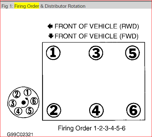

firing order and location of pistons an number them

I have the new distributor. I just need to know where the bottom end is to be in relation to the distributor line up mark and the position the distributor will be in once it is installed.

Here is a picture attached below. Let me know if you have any other questions. Check out the diagrams (Below). Please let us know what you find. We are interested to see what it is. Hope this helps and thanks for using 2CarPros.
