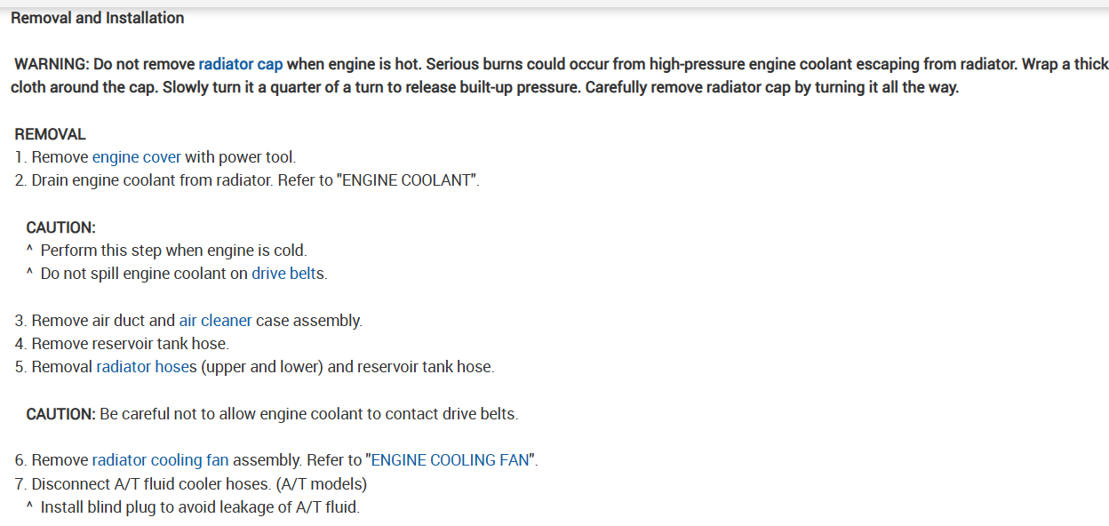

Radiator removal issue?
2005 NISSAN PATHFINDER
300,000 MILES • 2.0L • 4WD • AUTOMATIC
GENERAL_MADMAN056

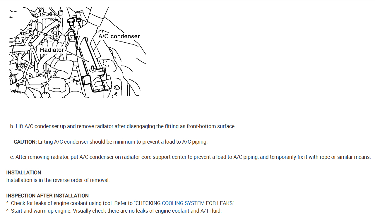

i have removed all the bolts and hoses i can find attached but i still can't seem to get it out.
Vehicle listed above r51 2005 di radiator.
Dec 12, 2024 at 11:50 PM
  • 54,837 POSTS

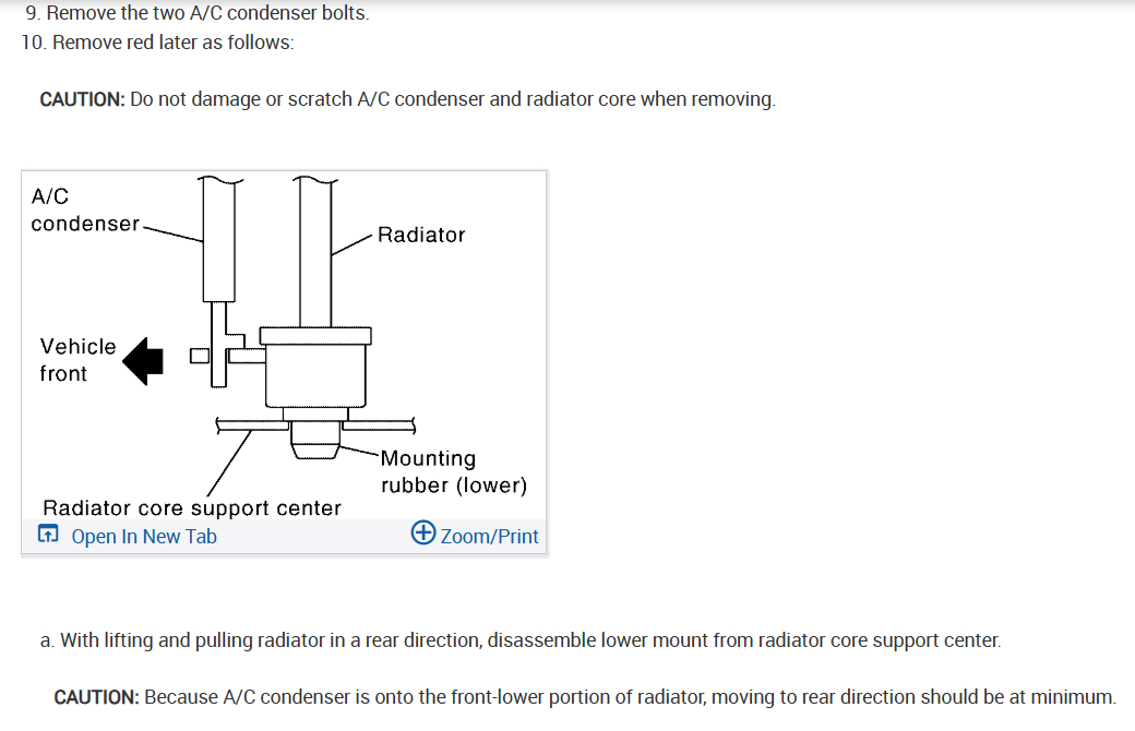

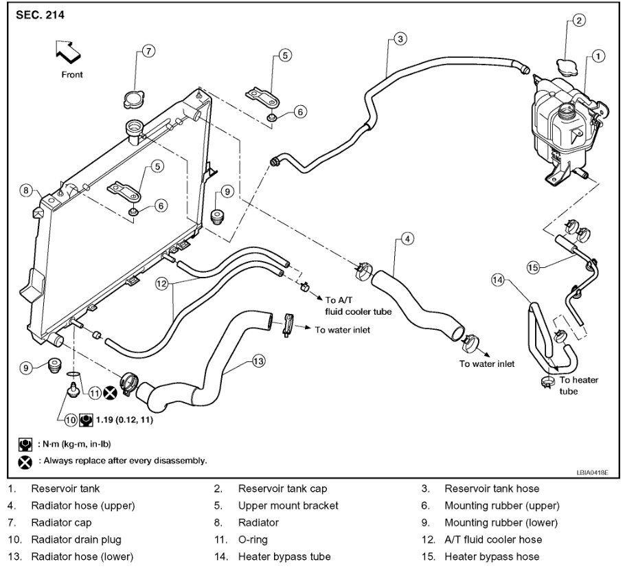

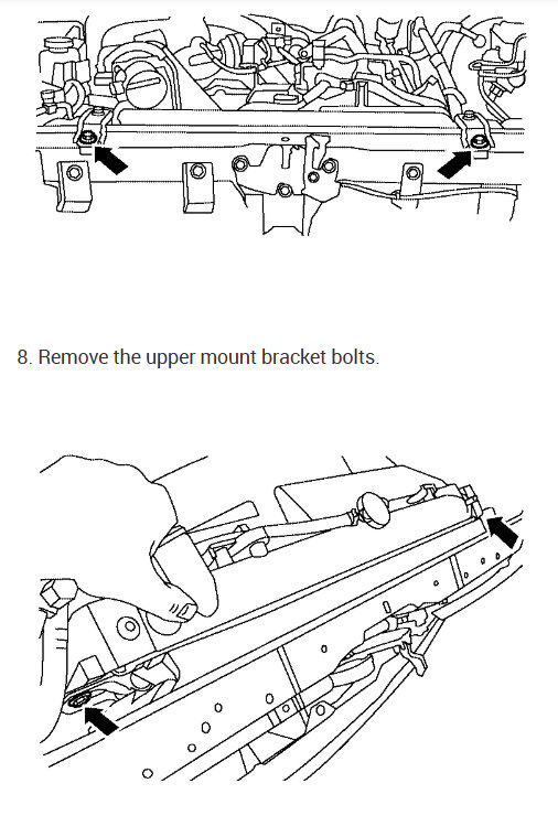

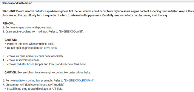

That is because the AC condenser needs to be pulled up and out of the lower radiator munts, please check the radiator removal instruction in the images below. Check out the images (below). Let us know if you need anything else.
