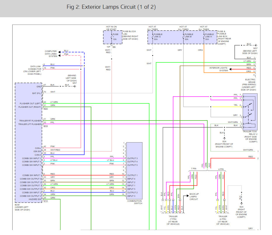

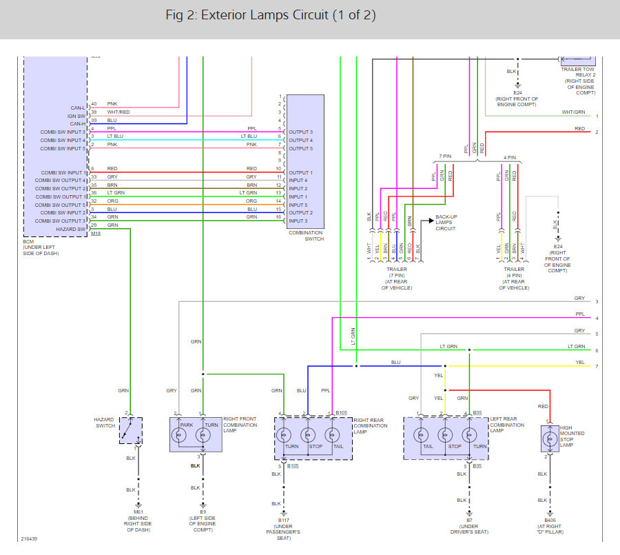

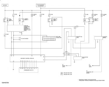

Ok first check fuse number 1 10 amp. Then in the under hood fuse relay box check fuse g 50 amp and fuse n 40 amp. CHeck fuse number 37 as well. Here is the diagram as to how it is wired. You will need to save it and then magnify it. Now if these fuses are all good then get back to me and we will do some pin tests to see if it is one of relay's or what. Let me know what you find.

Ok good now lets go straight to the BCM. Now what I need you to do is use the diagram that I sent in the priviouse response and save it and magnify it. Now term 52 is what sends power to the right side of the trailer harness for turn. Now probe that wire an turn on the blinker and if there is no power then it is the BCM, if there is power then it is a break in the wire somewhere. Let me know what you find. Thanks.

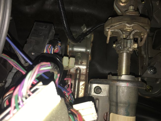

DICKYBOY
One of these two 10amp mini fuses are blown. It’s above the gas pedal behind those white rectangular plastic.
