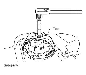

2005 Nissan Pathfinder 6 cyl Four Wheel Drive Automatic
I need to change the fuel sensor in the tank but cannot get the top off of the tank. It looks like it should turn but also has a plastic block to not allow a turn.
Friday, July 30th, 2010 AT 6:42 PM
MHPAUTOS
  • 31,937 POSTS
Hi there,
There is a tool required to remove the locking ring,
J-45722, see pic.
Mark (mhpautos)
https://www.2carpros.com/forum/automotive_pictures/61395_Graphic_161.jpg
