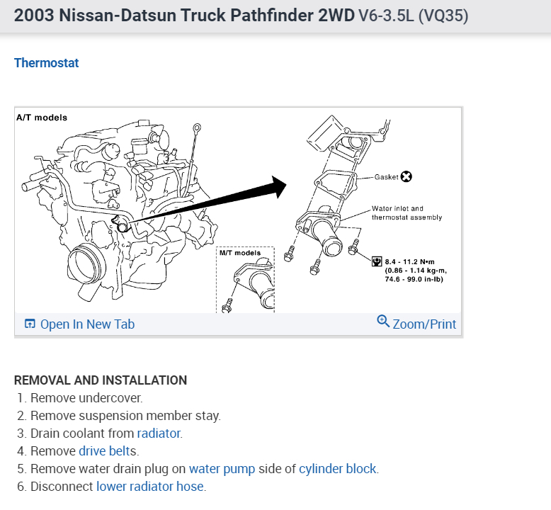

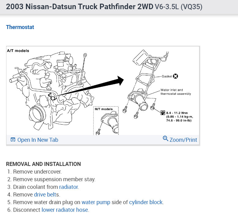

please tell me where the thermostat and housing are located and how difficult it is to replace?

I own a 2003 nissan pathfinder se, 6 cyl..please tell me where the thermostat and housing are located and how difficult it is to replace?

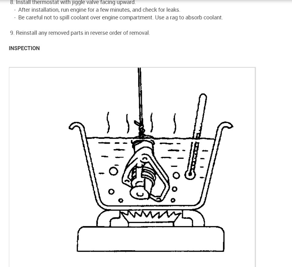

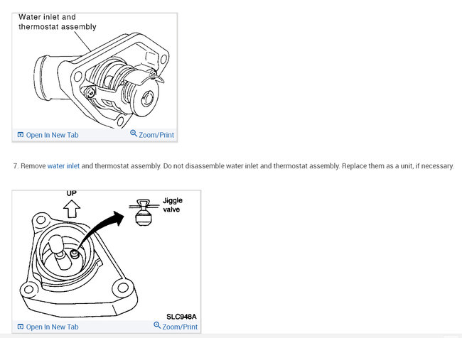

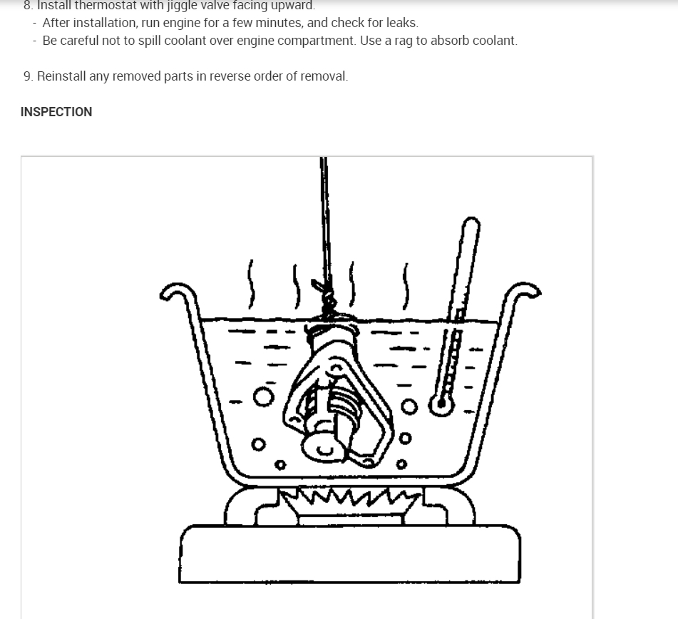

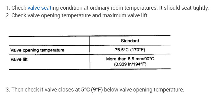

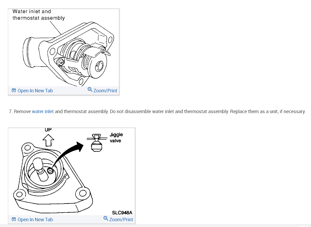

Here is a generic guide on how to change the thermostat out with specific instructions in the diagrams below to show you how on your truck.
