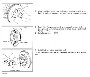

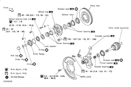

I'm trying to change the front rotors on the truck and was wondering what parts besides the brake caliper needs to be removed.
Friday, May 29th, 2009 AT 6:37 AM
MMPRINCE4000
MECHANIC
8,548 POSTS
Looks like the same setup as a Honda, where you have to remove bearing assy to remove rotor.
Use car repair manual link in this thread or get a Haynes manual. It will pay for itself just doing this repair.
