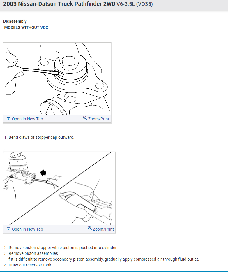

Replaced front brake pads, now pedal goes down to floor.
ERNIE BYERS
  • 2003 NISSAN PATHFINDER
  • 6 CYL
  • 2WD
  • 70,000 MILES

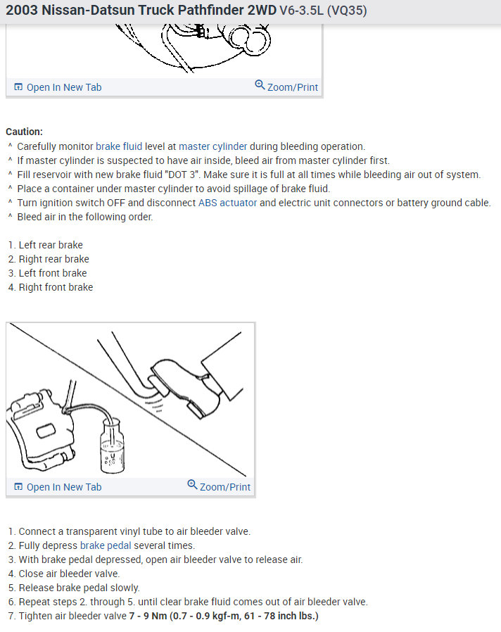

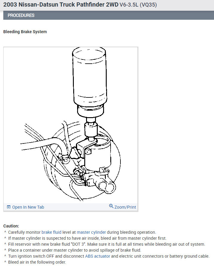

Replaced front brake pads, now pedal goes down to floor. Acts like air in system. What should I do. Don't know how to bleed. Please help.
Saturday, January 24th, 2009 AT 10:02 PM
SQM
  • 6,383 POSTS

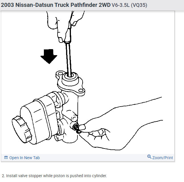

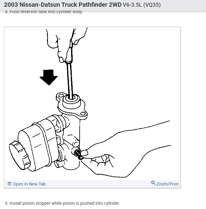

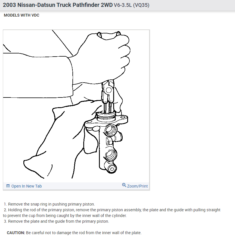

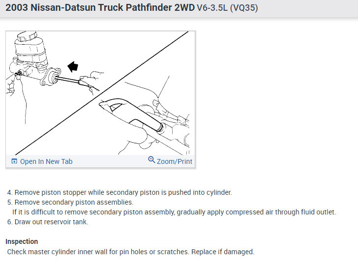

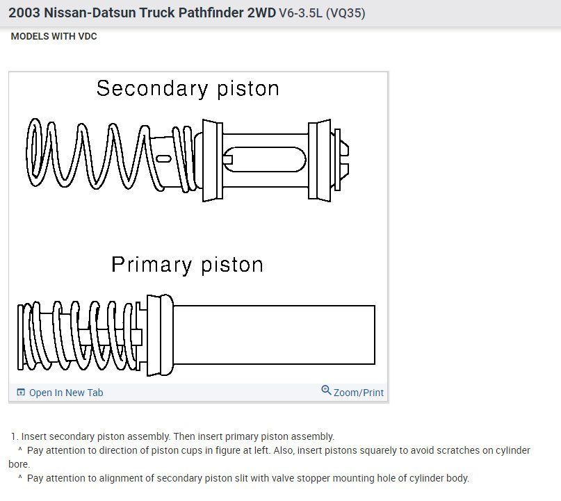

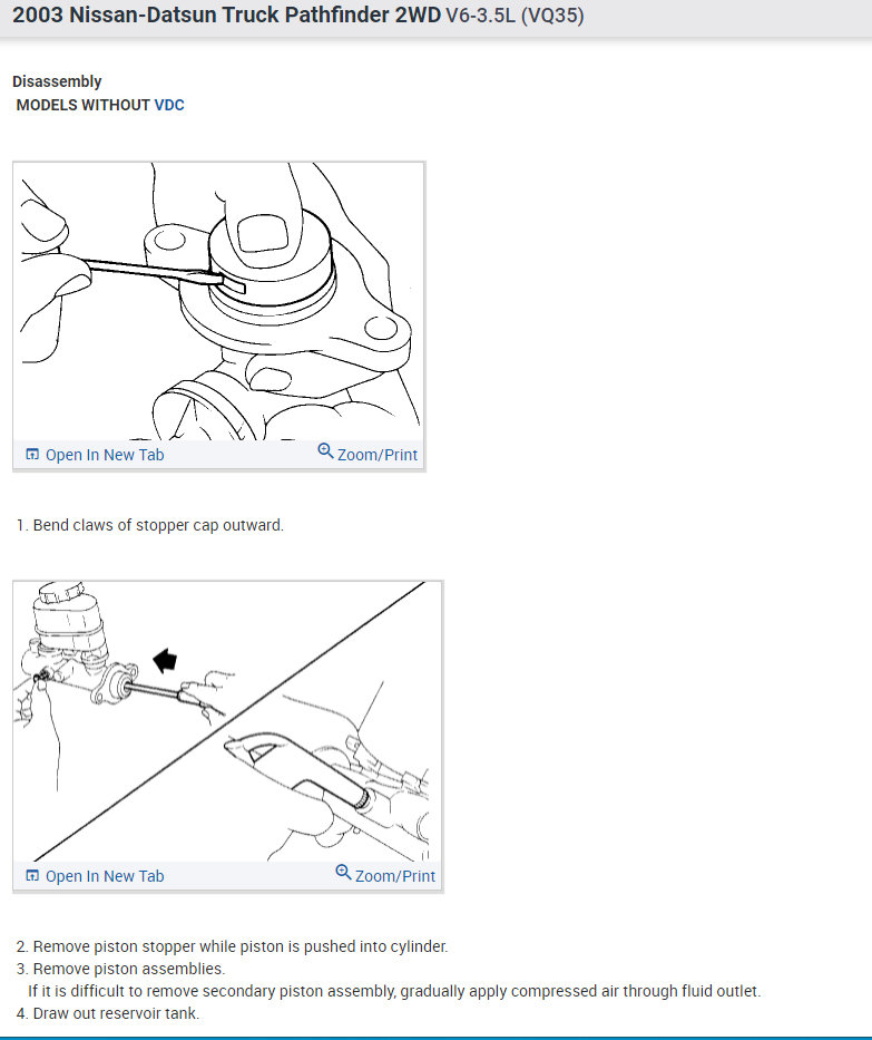

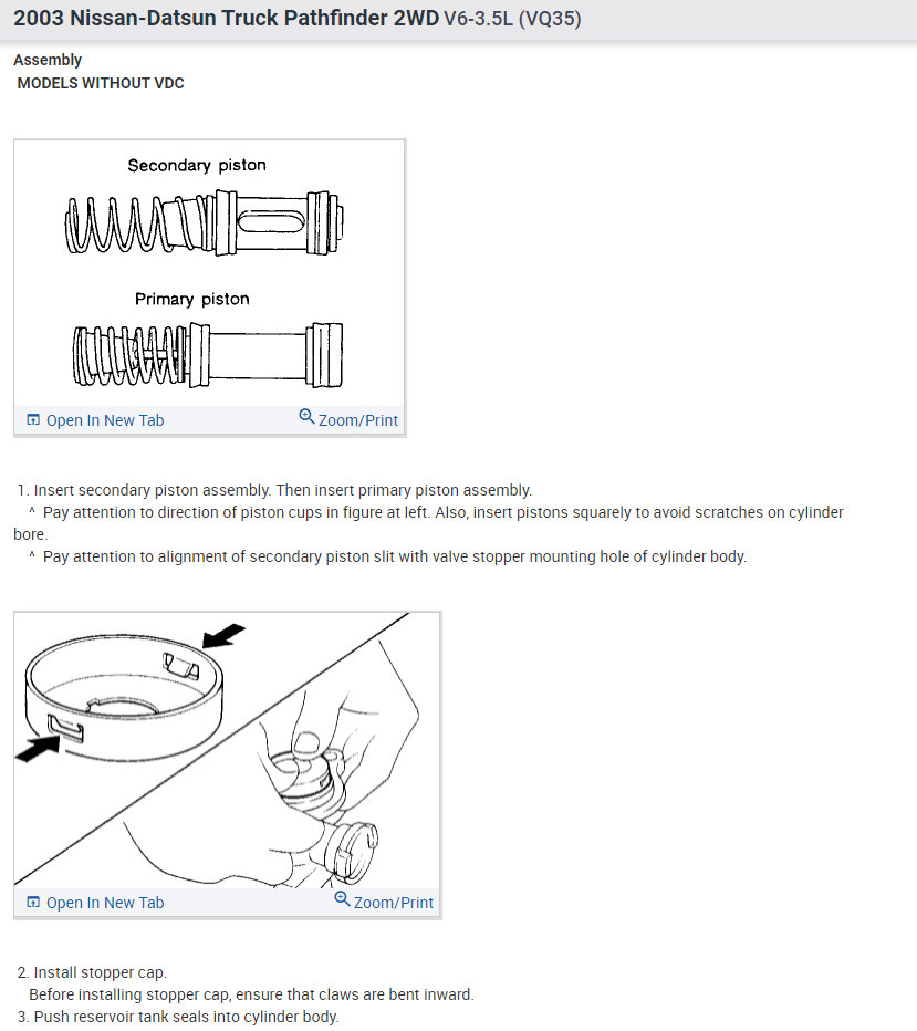

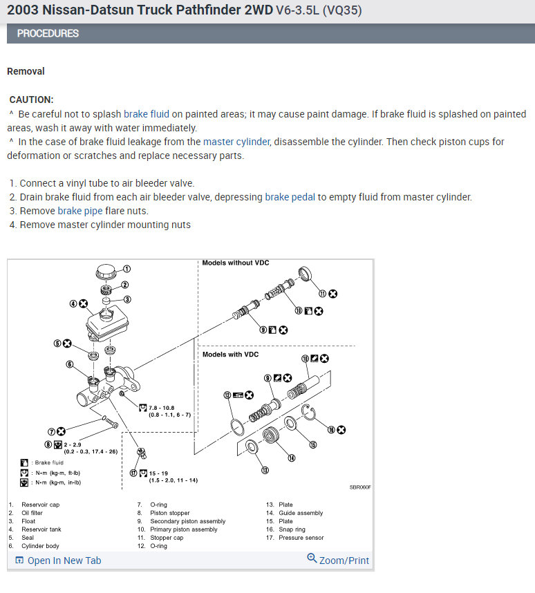

Brake pedal can go to the floor for few different reasons.
It can be air in the line that needs to be bleed. It can also happen if there is a leak in the brake line or a faulty master cylinder.
Take a look at this guide, it covers all the typical reasons:
https://www.2carpros.com/articles/brake-pedal-goes-to-the-floor
Here is a guide to how to bleed the brakes:
https://www.2carpros.com/articles/how-to-bleed-or-flush-a-car-brake-system
Thursday, October 7th, 2021 AT 9:01 AM
